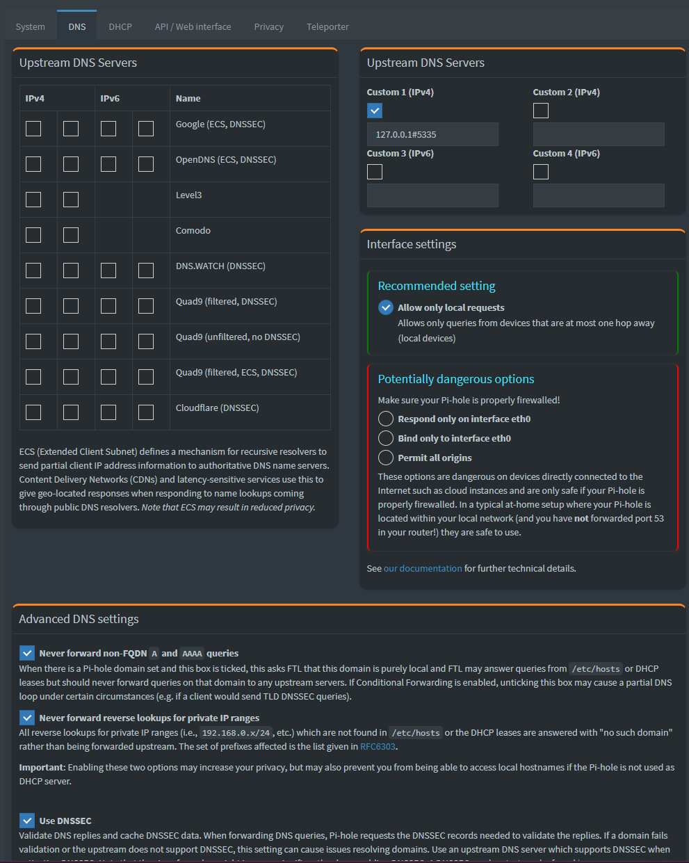

- My Settings >> DNS are in the attached image.

It is pointing to unbound. Which servers is the latter using?
On a default setup, it should be DNS root server. But I still guess it is the local network access that is cut off while the Killswitch is active.
