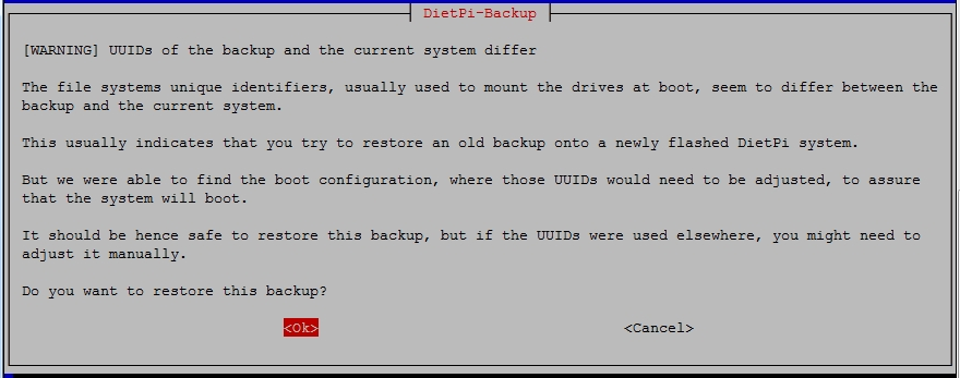

Hi Folks - between Saturday & Sunday the “rescue” has gone from bad, to worse, to major disaster. Abandoning the attempts to restore from 9.4.2 backup, I ran a fresh DietPi install over the 128GB drive and started from scratch.
