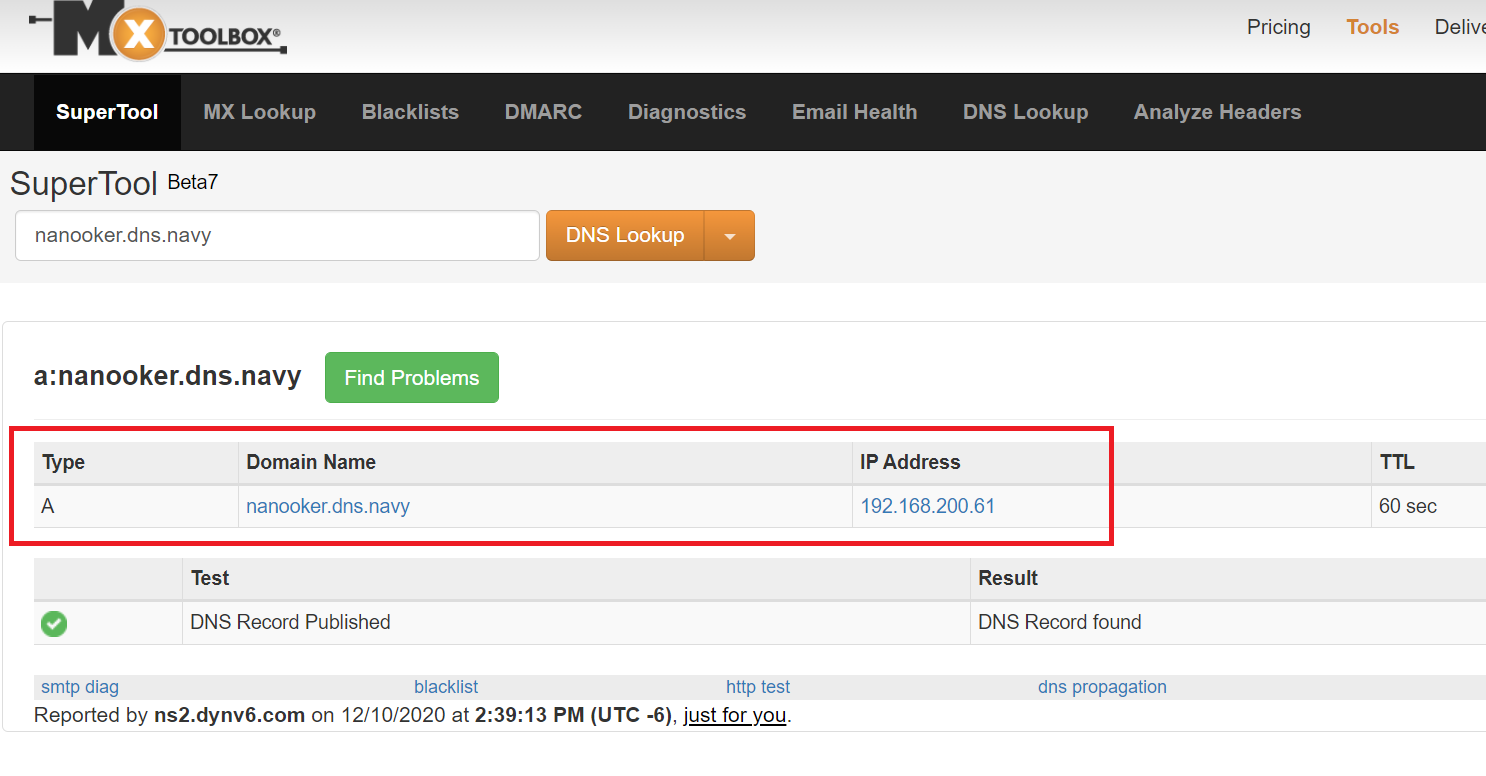

quite simple. You need to ensure to have correct IP address stored on your DDNS provider. Actually it looks like your privat one from your local network. For sure this is not working that way. I checked the domain and this is the result:
delete
basically you would need to find out which device is using 192.168.200.61. Probably there is a service running updating your DDNS wrongly.

well you need to find out what and why your DDNS is updated incorrectly. Otherwise you never will be successful

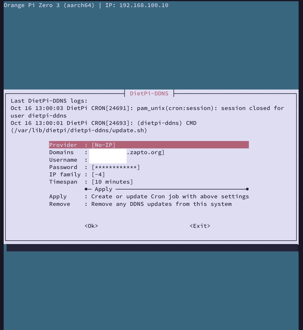

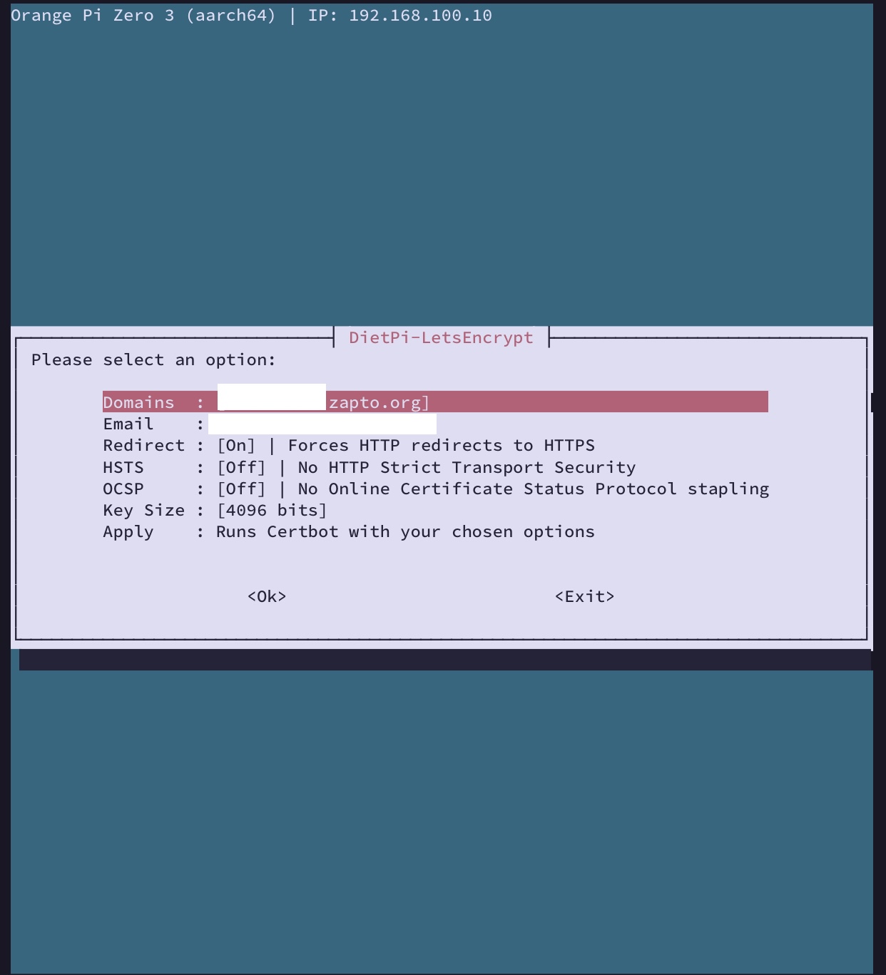

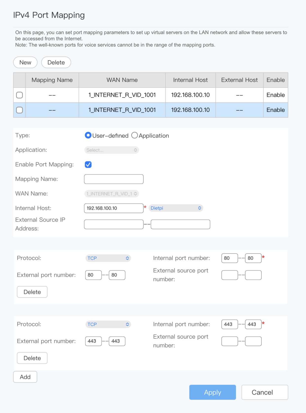

Need help, Not a tech savvy

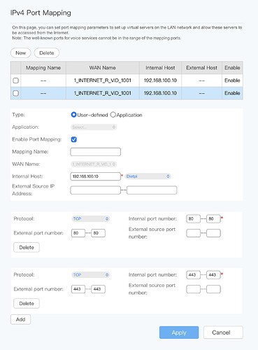

Ensure your external DDNS has been correctly updated and your port forwarding is pointing to correct devices.

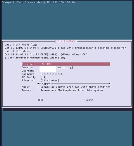

Am i doing it correctly with port forwarding on my router? After i opened these two ports for my pi, i went to set up my DyDns with No-ips, installed certbot, input all the data and it still gave all the same messages. Is there something that has to do with my isp ?
can you check within your No-IP account / web site if your IP address has been correctly setup?

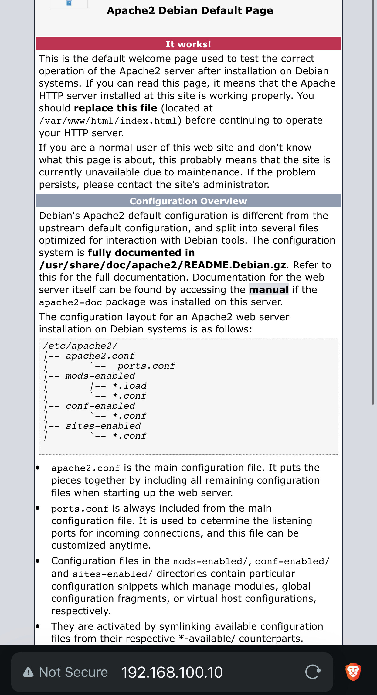

And are you able to reach your system from internet using port 80?
The IP on No-Ip account matches my public ip address. Do i have to configure it to match my dietpi local ip:192.168.100.10?
http://192.168.100.10:80
Access this through my wifi is working fine.
But if i connect through my public ip on port 80. It’s unreachable.
Another thing is that i also have Tailscale running on my Dietpi. Could this be the problem?
no it would need to be your external IP on NoIP.
for testing take a mobile phone on mobile network (not WiF), try to connect to your external IP address on port 80
