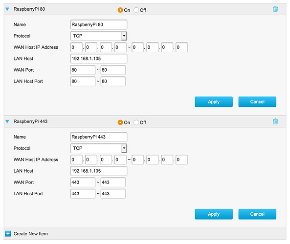

I’ve then logged into my router (ZTE) and configured port forwarding for 80 and 443 with my LAN IP.

  3. To double check, you have forwarded port 80/443 TCP (not UDP) on your router?

Do you have forwarded port 80/443 TCP (not UDP) on your router to DietPi device?
I believe so. I’'ve forwarded port 80 and 443 to the Pi’s LAN IP.

Pls can you double check port forwarding on your router
No additional security installed and I’ve set firewall settings to Low on my Router / Macbook.
Port forwarding is set up – my ISP said I need a static IP for this to work but I presume NO IP solves this problem?
