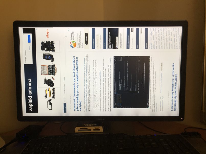

Your command rotates screen, but … it looks like in the below picture.
I tried many different combinations, but I don’t know how to strech the picture to the monitors resolutions…
which browser you are using now?
This is chromium. When screen is not rotated, everything is ok - it covers all screen area. But when I rotate it to left it looks like in the picture.
Maybe changing resolution from 1920x1080 to 1080x1920 could help? But when I tried to run xrandr with -mode 1080x1920 I got error that there is no such mode.

Yes, I set it up, and before rotating it looks ok (look at screenshot below).
But when I rotate screen it looks like it rotates without changing resolution from 1920x1080 to 1080x1920 (I think…)
Helped changing resolution for chromium in dietpi.txt from
Chromium
SOFTWARE_CHROMIUM_RES_X=> 1920
SOFTWARE_CHROMIUM_RES_Y=> 1080
SOFTWARE_CHROMIUM_AUTOSTART_URL=> https://dietpi.com
to
Chromium
SOFTWARE_CHROMIUM_RES_X=> 1080
SOFTWARE_CHROMIUM_RES_Y=> 1920
Now it looks like I wanted
But after restart, screen rotate backs to its previous setting. What should I do to make it permanent?
