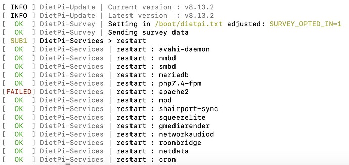

root@DietPi:~# journalctl -u apache2
-- Journal begins at Tue 2023-01-24 15:17:01 GMT, ends at Wed 2023-01-25 09:55:06 GMT. --
Jan 24 15:17:21 DietPi systemd[1]: Starting The Apache HTTP Server...
Jan 24 15:17:21 DietPi apachectl[1088]: [Tue Jan 24 15:17:21.838613 2023] [:crit] [pid 1088] (38)Function not implemented: AH00141: Could not initialize random number generator
Jan 24 15:17:21 DietPi apachectl[1077]: Action 'start' failed.
Jan 24 15:17:21 DietPi apachectl[1077]: The Apache error log may have more information.
Jan 24 15:17:21 DietPi systemd[1]: **apache2.service: Control process exited, code=exited, status=1/FAILURE**
Jan 24 15:17:21 DietPi systemd[1]: **apache2.service: Failed with result 'exit-code'.**
Jan 24 15:17:21 DietPi systemd[1]: **Failed to start The Apache HTTP Server.**

That will be it. Umm, I hope it is not a definit hardware/kernel limitation that is not working anymore with Apache2 on Bullseye. We can generate images with Lighttpd or Nginx pre-installed, if that is the case. Let me check.
EDIT: It is a limitation of the kernel:
Nothing we can do about it, as Allo never provided a newer kernel and there is no mainline support for this Actions semiconductor S500 SoC. However, we can generate a Lighttpd-based Allo GUI image.

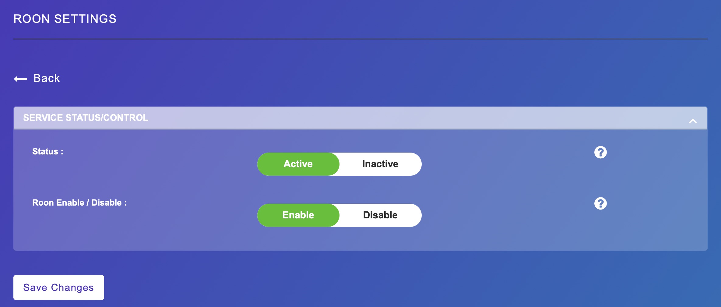

EDIT: Ah, I think the Allo GUI renames the service files to disable them. Please try to re-enable it via Allo GUI, if this was the case.
mkdir: cannot create directory ‘/etc/systemd/system/roonbridge.service.d’: File exists
Failed to restart roonbridge.service: Unit roonbridge.service not found.
