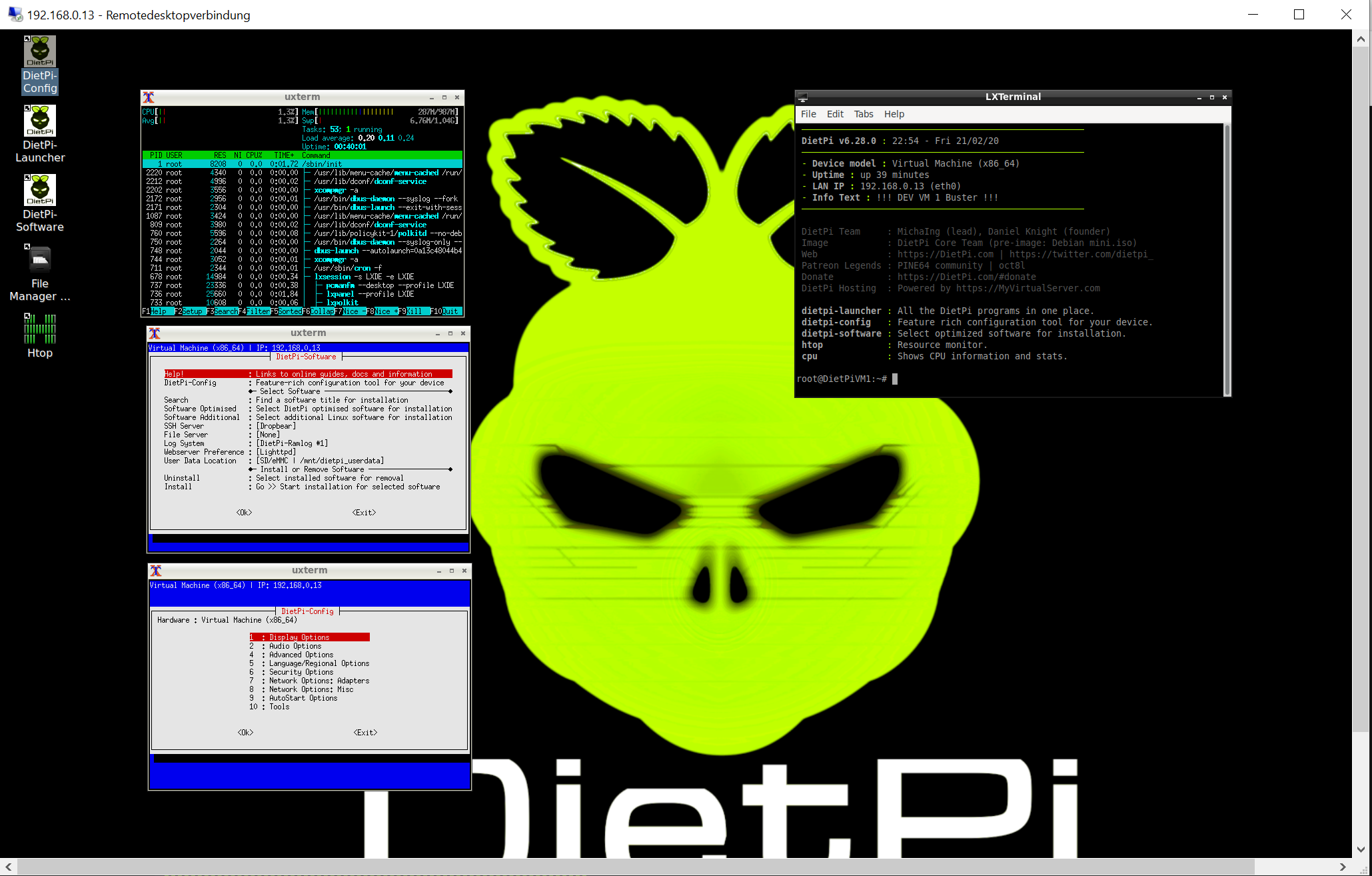

The screenshot is kind of useless for this issue since it just shows my deskop but it is attached. I can move my cursor but I can’t interact with anything either by clicking or using my keyboard, i.e. I can look but not do.
