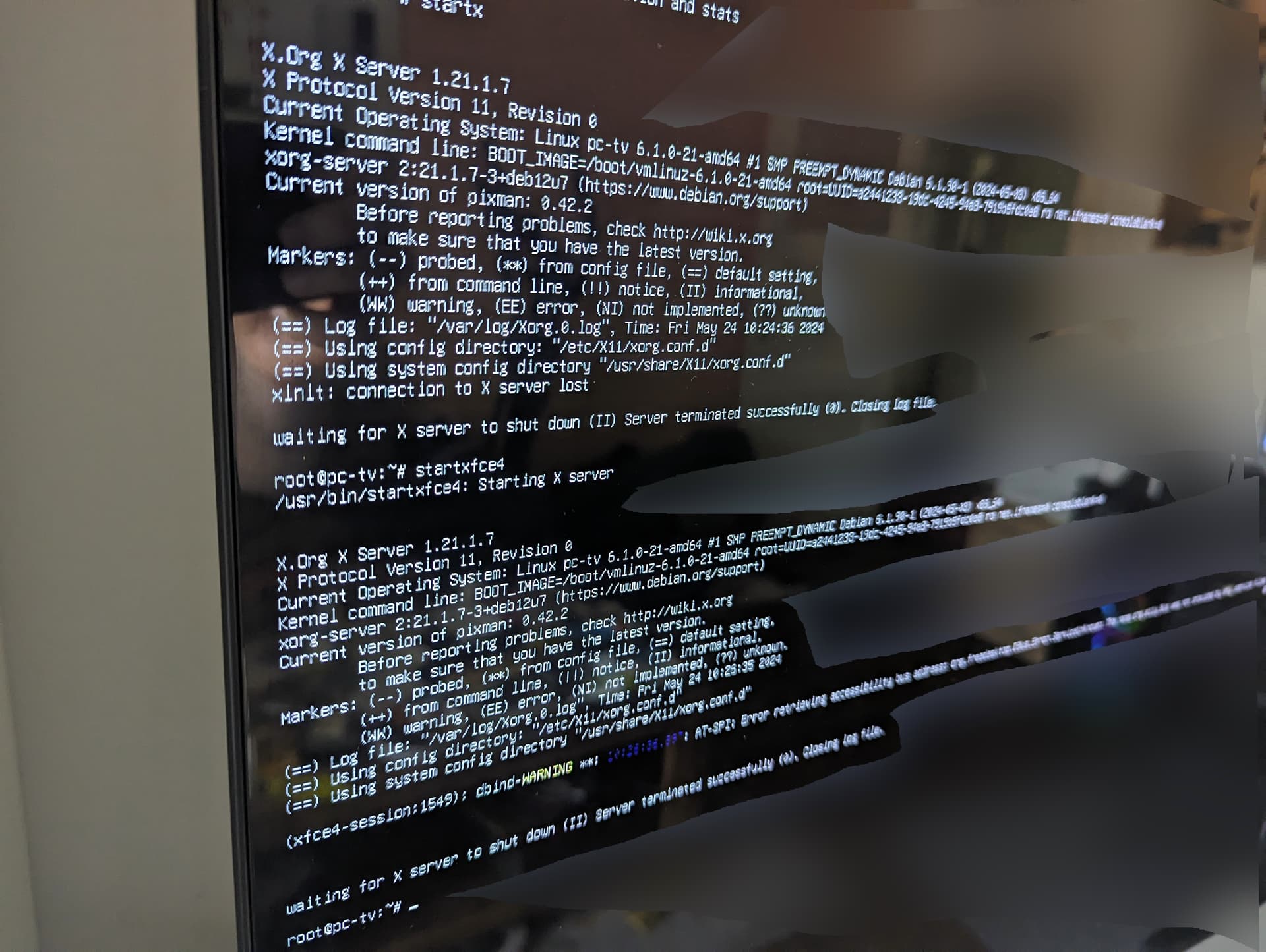

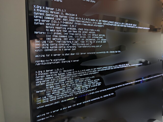

  1. Install Xfce
  2. Run startx or startxfce4
  • Desktop starting
  • AT-SPI: Error retrieving accessibility bus address: org.freedesktop.DBus.Error.Service.Unknown: The name .org.a11y.Bus was not provided by any .service files.
  • See Photo
  • Installed at-spi2-core, did not fix the issue.

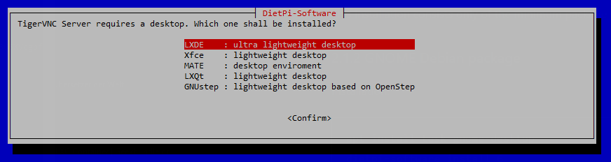

But when I try to install a VNC server now, it asks me which desktop to install?
Yeah because DietPi does not offer GNOME, so you installed it on your own and the script can not detect it.

Installed Xfce again. It does not throw an error on startxfce4, instead the screen just turns black, then No Signal. What now?

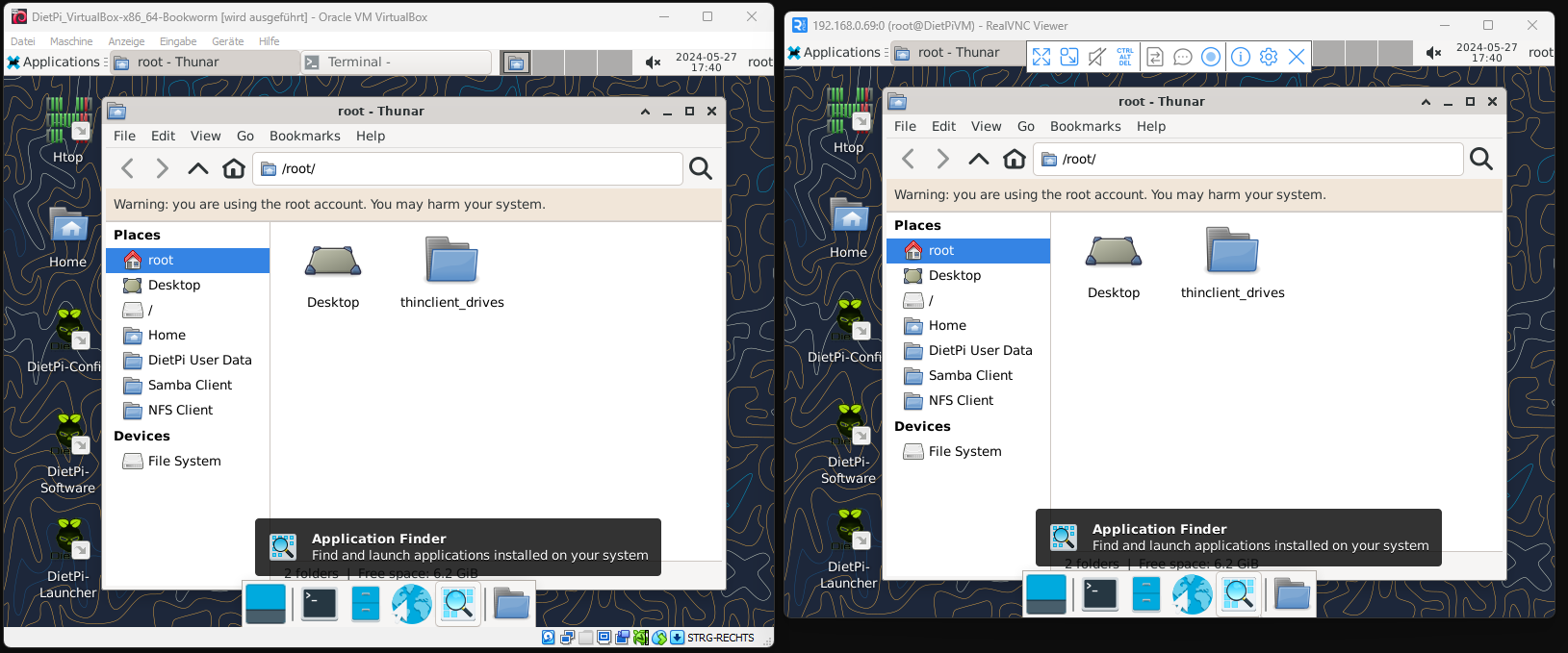

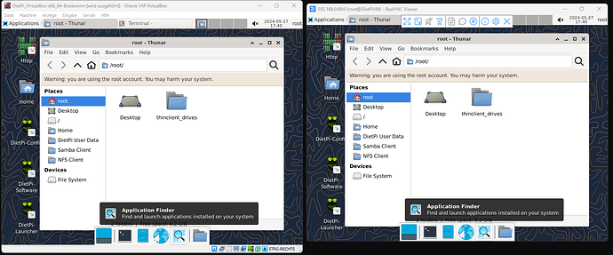

I have no issues to setup VNC using Xfce
left hand side is a VM running inside VBox
right hand side is the VNC session

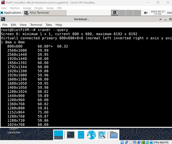

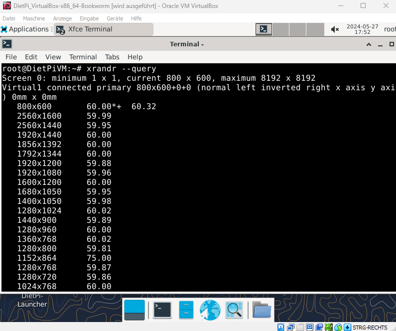

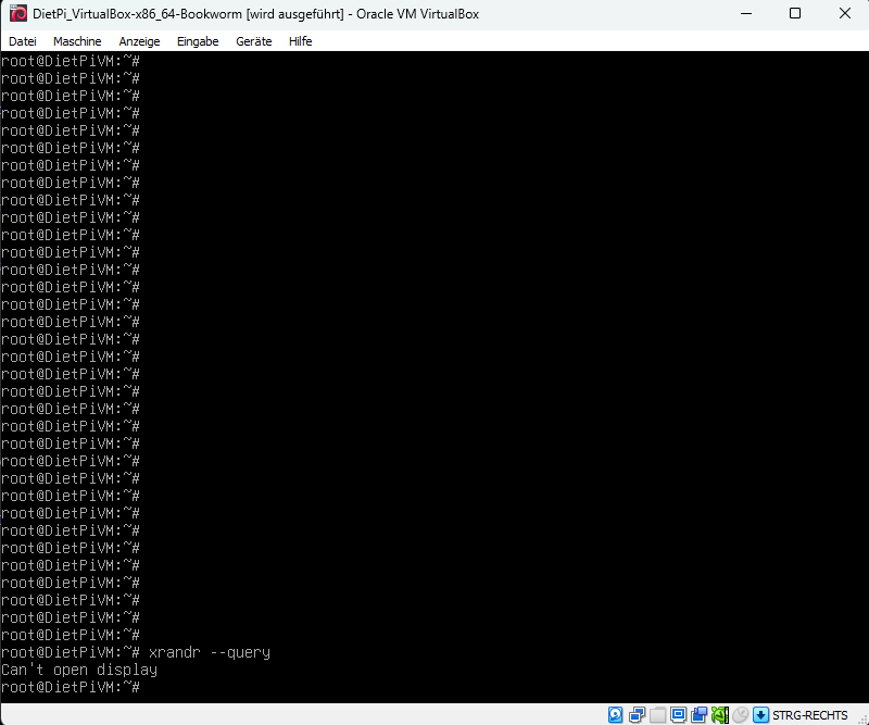

root@pc-tv:~# xrandr --query
Can't open display
this would require a xsession if I’m not mistaken
At least I can start it from a running desktop
But not from command line
So what can I do now to start Xfce?
