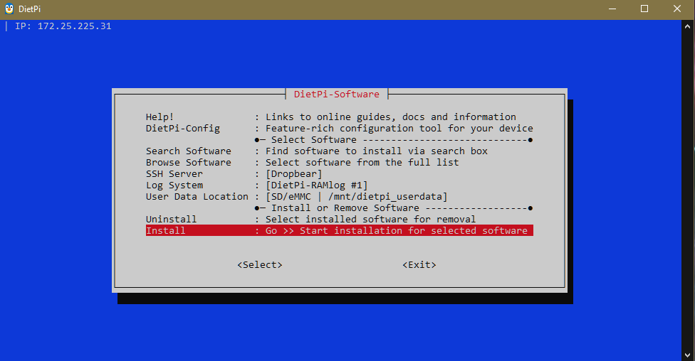

OK I found another solution, without systemd-networkd etc. You can just mask the services (why did I not think about this earlier?) and WSL will not re-enable them again after restart. If they are only deactivated they will be alive again on next start of the VM.
So here is what I did:
Install Debian via root-fs tarball via powershell (I have already Debian installed via WSL and you can not install a second one by default. This is my workaround):
wsl --import DietPi M:\WSL M:\Downloads\rootfs.tar.xz
DietPi is the name of the WSL instance, M:\WSL is the path where the vhdx of the VM will be stored. The last argument is the path to your tarball.
I started then the VM, installed nano (apt install nano) and created the wsl config file nano /etc/wsl.conf with the contents:
[boot]
systemd=true
[network]
generateResolvConf=false
[automount]
enabled=false
automounts false prevent WSL from mounting any windows partitions.
After that I stopped and masked networkd and resolved.
Then stop WSL via powershell wsl --shutdown, restart the VM and follow the instructions from the docs
apt update
apt install -y curl ca-certificates systemd-sysv
bash -c "$(curl -sSfL 'https://raw.githubusercontent.com/MichaIng/DietPi/master/.build/images/dietpi-installer')"
I choose then VM, it hang on some point, it needed dpkg --configure -a whichI did in a second terminal. It ran then through :smiley:
On reboot the first install script started and complained that no journal is present.
But now it’s up and running.
After the init installation it hang up on the cron service :smiley: damn!
It also can not create an UUID for the survey. Let’s what else is broken.
