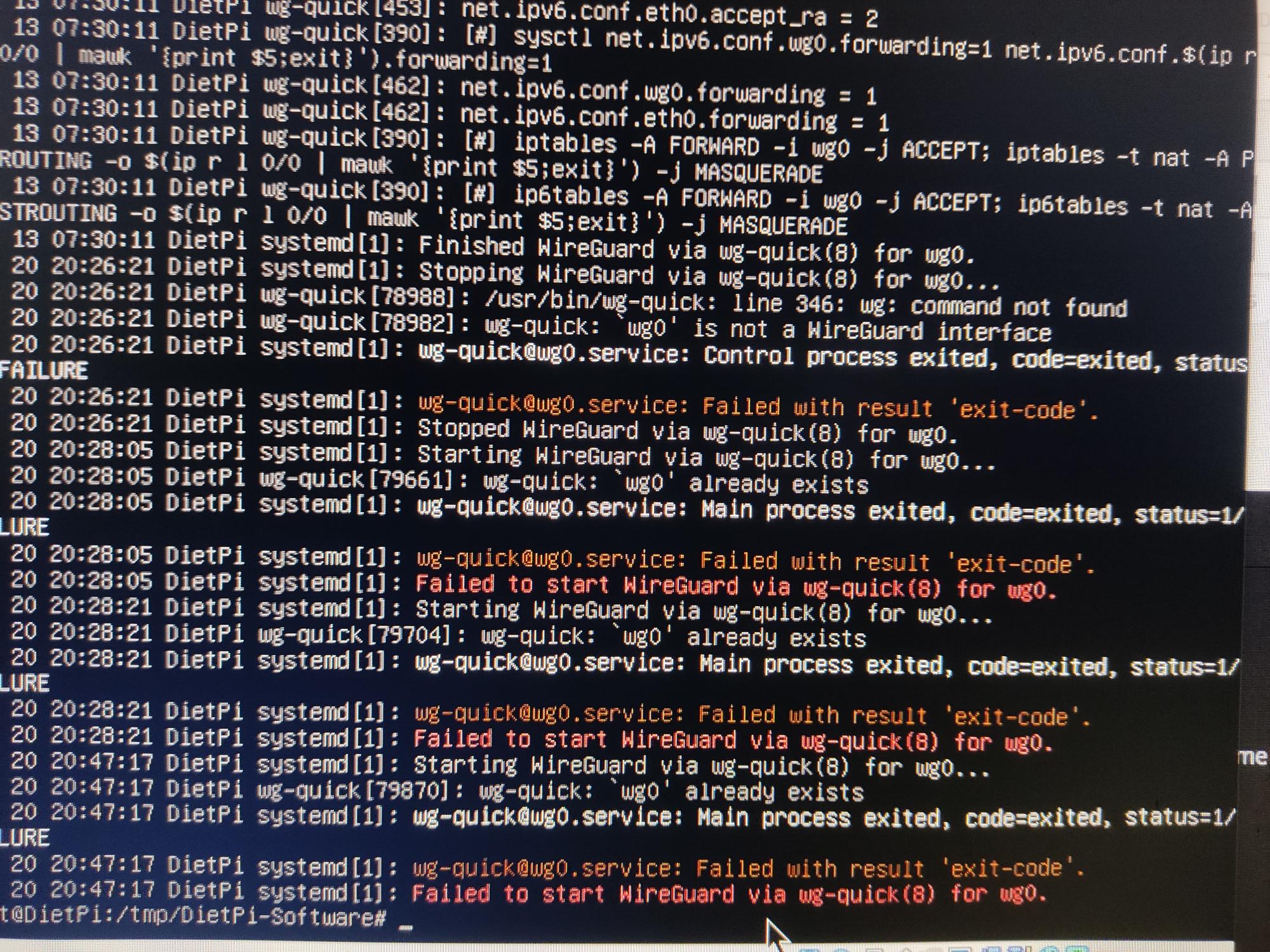

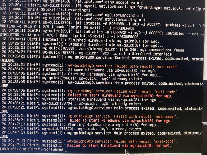

The log says:
wg-quick: 'wg0' already exists.
So the interface wg0 is already running.
Maybe you can try wg-quick down wg0 and then restart the wg-quickservice? :thinking:
But the question is, why is it alrready running.

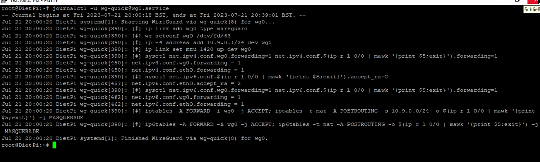

Pls reboot and share again following once system is back online. Try to connect via SSH
journalctl -u wg-quick@wg0.service
Wireguard server seems to be up and running correctly. This indicates a client issue. Probably incorrect or not up to date DDNS or missing port forwarding on the internet router.
