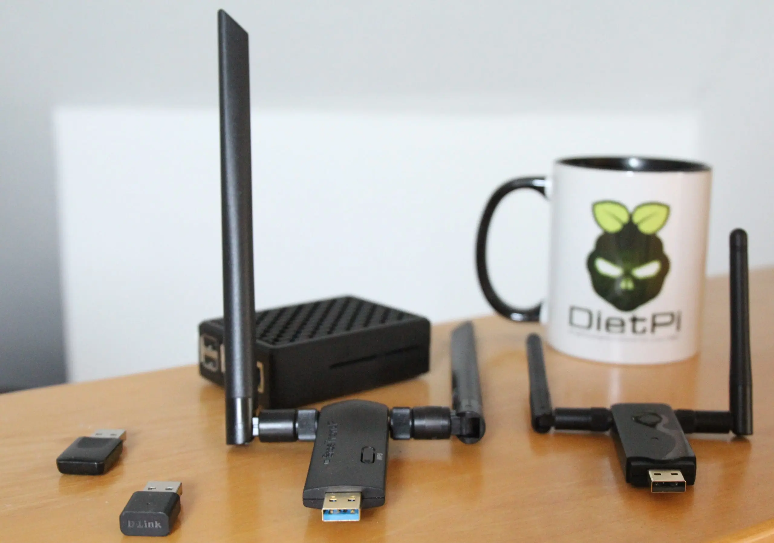

I followed the above mentioned blogpost. It’s working fine when using only the onboard wifi.
It’s not working (hostapd is not starting) when using either a TP-LINK TL-WN823N or an D-Link DWA-131 which are supposed to be tested & working OK.

Are you sure your external adapter supports AP mode?
I think so because both of my adapters are mentioned here:
Tested external USB WiFi adapters
