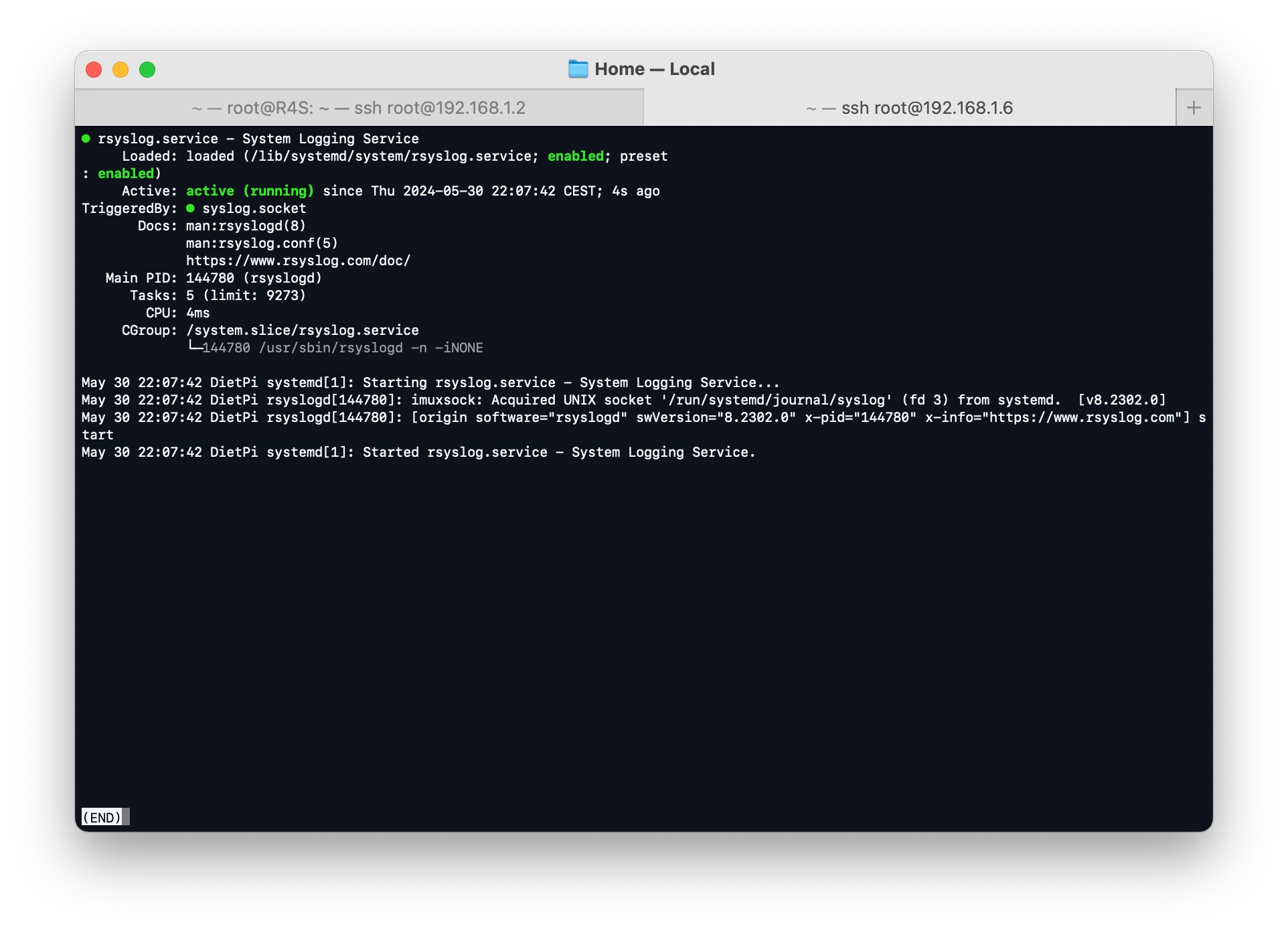

Edit: here’s a screenshot with a “short service output”, as you can see there is still the END instead of the prompt, and I have to ctrl-c to “exit”, but I still haven’t the prompt after ctrl-c, I have to press again it or press enter to make the prompt “works”. It’s hard to explain, the video explains better!
When END is highlighted you can press q to quit.
