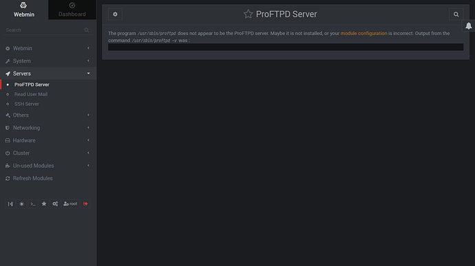

Hi all,
I can’t seem to get Webmin to work with ProFTPD — when clicking on the ProFTPD Server module, it just says "The program /usr/sbin/proftpd does not appear to be the ProFTPD server. Maybe it is not installed, or your module configuration is incorrect. Output from the command /usr/sbin/proftpd -v was : "
Is there any way to get this working? Thanks

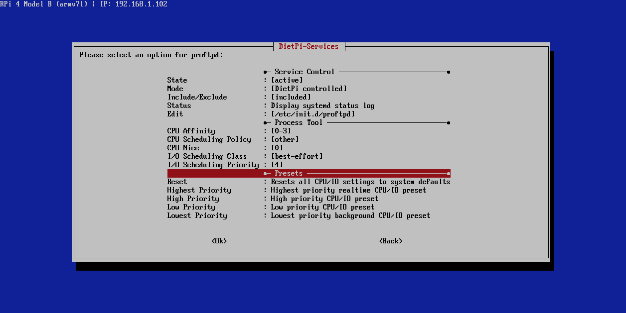

● proftpd.service - LSB: Starts ProFTPD daemon
   Loaded: loaded (/etc/init.d/proftpd; generated)
   Active: active (running) since Mon 2020-04-27 12:17:18 BST; 6h ago
     Docs: man:systemd-sysv-generator(8)
    Tasks: 1 (limit: 4915)
   Memory: 2.6G
   CGroup: /system.slice/proftpd.service
           └─2514 proftpd: (accepting connections)

I don’t think you understand — ProFTPD is working and running. I am able to connect to the server and download/upload files. Webmin isn’t working to adminster it though.
I understood you already. Your problem is that Webmin is not detecting your ProFTP installation and this needs to be found out why. As well you stated on your first post that proftpd -v dosn’t give anything back. But usually it should state the ProFTP version. So there might be something wrong on ProFTP
I didn’t say that typing in proftpd -v gives no results, I said that Webmin is giving that error in the ProFTPD module.
When I type in proftpd -v it returns the version number. It is webmin that doesn’t see it.

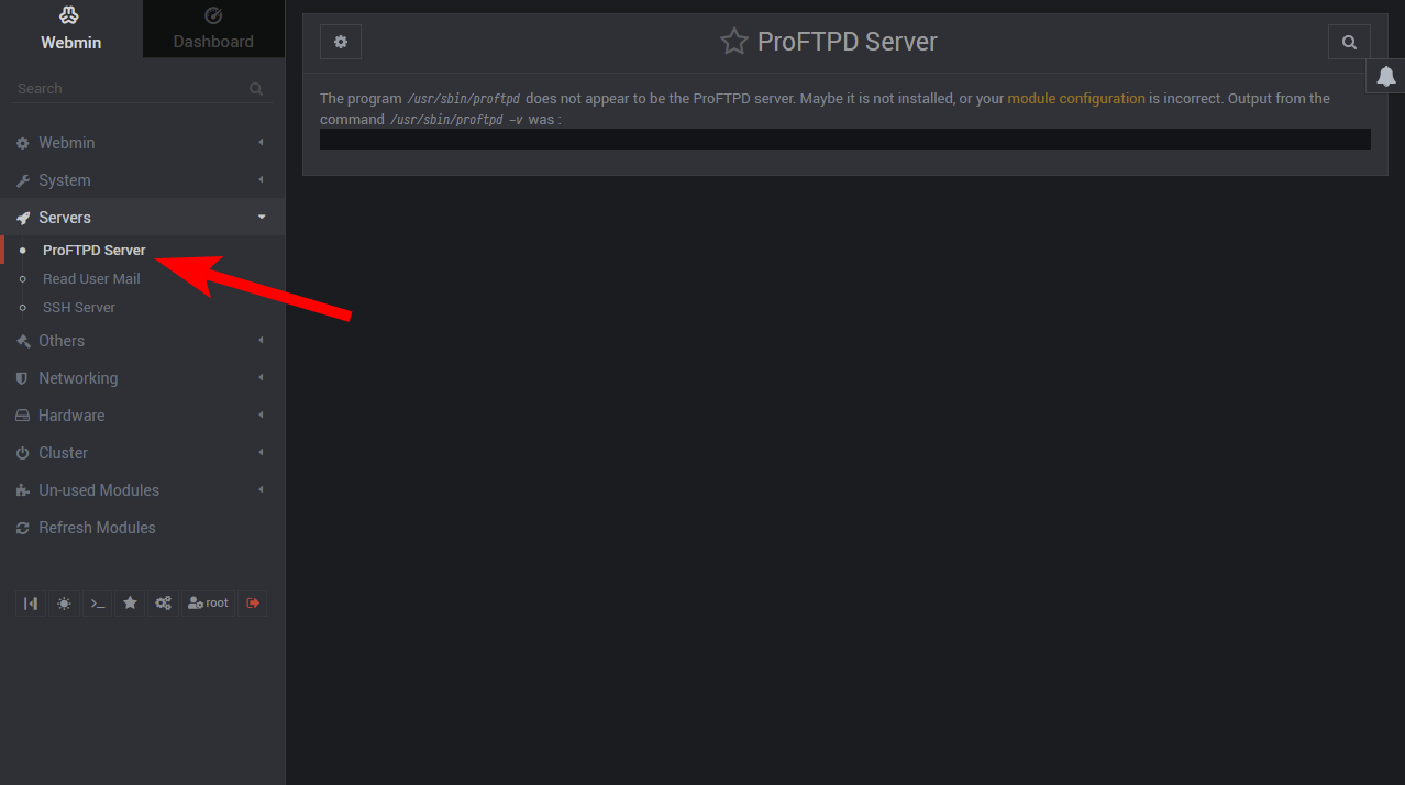

what button you need to push to get the output of your 2nd screen shot?
  1. Login to Webmin
  2. Click Servers
  3. Click ProFTPD Server
ok for me this is working fine. Seems Webmin has on issue to run proftpd correctly. can you try to open a terminal inside Webmin (ALT+K) and check what proftpd -v will return
