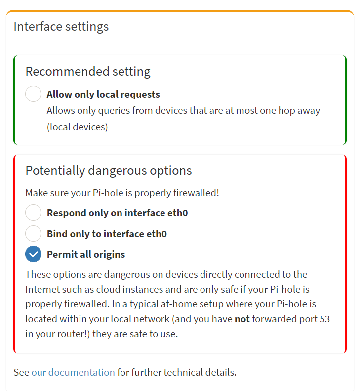

well you could do what has been stated on the warning message. Check PiHole documentation https://docs.pi-hole.net/ftldns/dnsmasq_warn/
Looks like your PiHole s receiving DNS request from outside of your local network.

If you like to get ride, as well you could allow PiHole to answer DNS request for all clients. Dosen’t matter where they are from :sunglasses:

As along as you don’t forward port 53 on your router to DietPi device, you should be save to use other options. This as well is stated on the option I showed above.

The setting to allow all request is available on Settings → DNS
BTW warning are disappeared because your DNS server was restarted while enabling logging. Usually it is fine to have logging disabled.
I found the settings and configured them as suggested.
