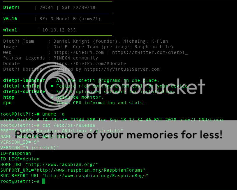

Actually this is Stretch not Jessie…its the latest Dietpi image…however the network issue is here.
