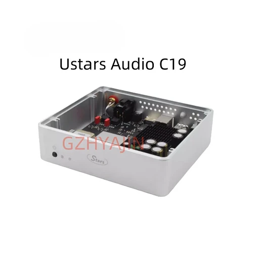

Now the damage is done, I have ordered a UStar C19 based on a CM4 module for my audio applications.
Here are my questions:
- Can I install Dietpi on the Ustar C19 ?
- If so, since there are no visual interfaces to connect a monitor.
How do I install the operating system on it?
I mentioned a PC in passing.
Here is some more information about the C19.
I’m not sure if anyone can answer this question, as probably no one has ever tried anything like this. Theoretically you can test if one of the existing RPI images will boot.
