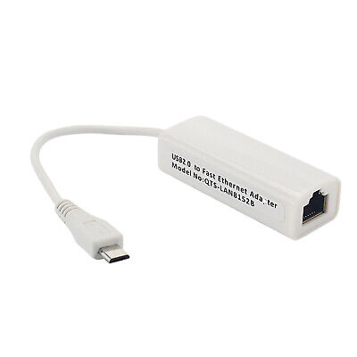

I tried to install and configure DietPi on a Raspberry Pi Zero. I wanted to use a USB LAN adapter, but I don’t seem to be connected to the network via LAN.
I used this LAN Adapter:
I have mounted the SD card and configured it accordingly.

What can I configure differently? And yes, 192.168.3.1 is my gateway, so a 192.168.3.100 or any other IP address on this network would be desirable.
Thanks in advance.
