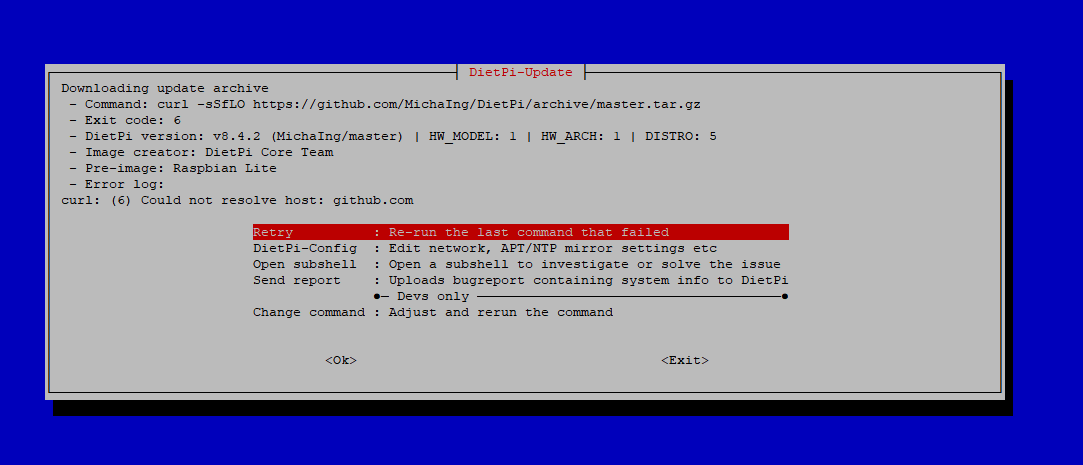

Hello, unfortunately I always get an error message when I want to update DietPi.
Greetings
Update available:
Current version : v8.4.2
Latest version : v8.5.1
Bugreport: cd10dac7-58ef-443a-83e3-6313f17843c9
The problem is that you cannot resolve the github.com.
I suppose that resolving works fine if you try when you are not in dietpi-update, right?
Maybe you are using some service like adguard or pihole on this device and the local nameserver is pointing to this service? During dietpi-update services are disabled, so there won’t be any response to the queries. You can add another nameserver in /etc/resolv.conf to have an alternative.

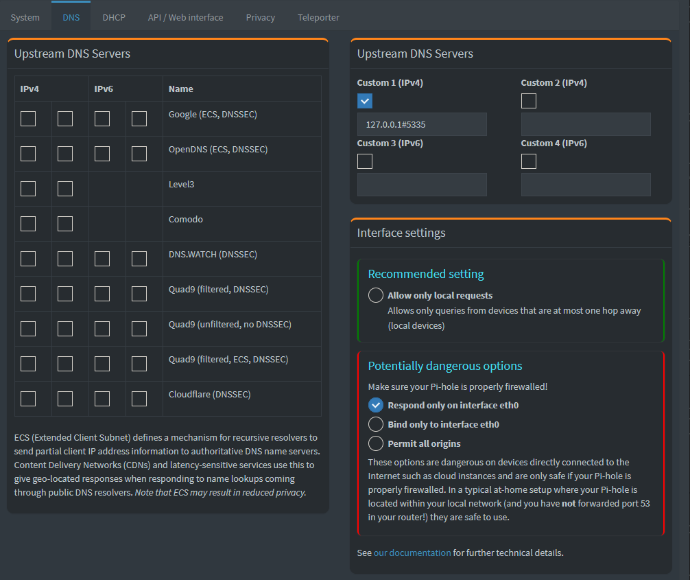

DietPi also runs as Unbound.

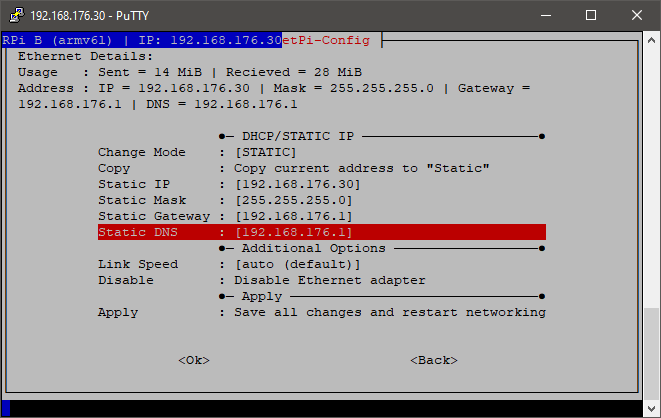

nameserver 192.168.176.1 (is my FritzBox)

My Fritzbox (DHCP) has a dynamic IP, at least I get a new one after every restart. DNS on my FritzBox points to my Raspberry Pi as the DNS-server.
That means: enter an external DNS server on my Fritzbox (like dismail), no unbound.

Simply switch your DietPi device to STATIC IP and adjust the DNS server in DietPi to a global upstream DNS. Inside your F!B create an IP address reservation for the DietPi device. This way the IP address should not be assigned to other device. In general it is highly recommended to use a STATIC IP on a device running PiHole.
All right. Understood.
My RaspberryPi had a static IP in my network, of course.
Does this fit with the Unbound IP in PiHole?
Otherwise, I have now changed “Static DNS” to the following two servers:
DNS-over-HTTPS- und DNS-over-TLS-UnterstĂźtzung [ffmuc.net/wiki/] and Service Info | dismail.de

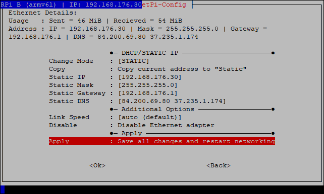

Don’t set any DoT DNS server directly on DietPi network configuration. This is not gonna work. Simply use a global upstream DNS like 1.1.1.1 or 9.9.9.9. The configuration you will do inside DietPi network will not have any impact on how PiHole + Unbound will work inside your network. These are 2 completely different thinks.

I have now entered the following two servers, which DietPi also has in the suggestions.
37.235.1.174 Austria 37.235.1.174 IP Address Details - IPinfo.io
84.200.69.80 Germany 84.200.69.80 IP Address Details - IPinfo.io
I wanted servers from Europe. Greetings :slight_smile:
putty_qQikIRu9Om
you are free to choose whatever DNS server you like, at least as long they are able to resolve GitHub now :stuck_out_tongue_winking_eye:

To be honest, I can’t quite figure out “DietPi Static DNS” and “Unbound” yet. I always thought that Unbound is my DNS server that sends the requests to https://www.internic.net/domain/named.root without using 8.8.8.8 or 9.9.9.9.
But if I understood you correctly above, the DietPi Config requires known upstream servers that have nothing to do with my surfing behaviour within my network?
