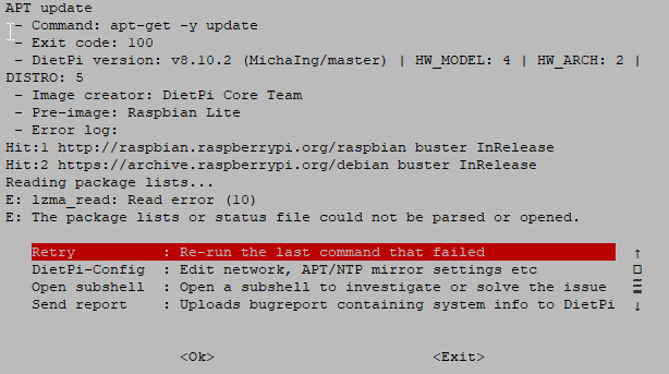

  1. SSH into RPi, used β€˜sudo dietpi-update’
  2. Reboot upon request
  3. RPi will not boot
Red light shows on RPI, but not flashing. Is connected to network via ethernet and no activity lights. Left for several hours to establish if running fsck, but no change upon second reboot.
Any ideas? This is not the first time this install has failed on update, last time I just started fresh but don’t want to do that. SD card mounts on Mac just fine, could I retrieve the config and software and start fresh?
try to connect a screen and check if there is anything showing up. But there might be nothing if no activity LED is flashing.
Nothing upon connecting to a display.

Preparing to unpack .../27-sudo_1.8.27-1+deb10u5_armhf.deb ...
Unpacking sudo (1.8.27-1+deb10u5) over (1.8.27-1+deb10u4) ...
Setting up libssl1.1:armhf (1.1.1n-0+deb10u4) ...
Setting up isc-dhcp-client (4.4.1-2+deb10u3) ...
Setting up libkrb5support0:armhf (1.17-3+deb10u5) ...
Setting up php7.3-common (7.3.31-1~deb10u3) ...
Setting up sudo (1.8.27-1+deb10u5) ...
Setting up libk5crypto3:armhf (1.17-3+deb10u5) ...
Setting up php7.3-intl (7.3.31-1~deb10u3) ...
Setting up php7.3-xml (7.3.31-1~deb10u3) ...
Setting up php7.3-opcache (7.3.31-1~deb10u3) ...
Setting up git-man (1:2.20.1-2+deb10u8) ...
Setting up rpi-eeprom (16.0-1~buster) ...
Setting up libkrb5-3:armhf (1.17-3+deb10u5) ...
Setting up libtiff5:armhf (4.1.0+git191117-2~deb10u7) ...
Setting up php7.3-zip (7.3.31-1~deb10u3) ...
Setting up openssl (1.1.1n-0+deb10u4) ...
Setting up php7.3-gd (7.3.31-1~deb10u3) ...
Setting up php7.3-sqlite3 (7.3.31-1~deb10u3) ...
Setting up php7.3-mbstring (7.3.31-1~deb10u3) ...
Setting up php7.3-json (7.3.31-1~deb10u3) ...
Setting up php7.3-readline (7.3.31-1~deb10u3) ...
Setting up libgssapi-krb5-2:armhf (1.17-3+deb10u5) ...
Setting up php7.3-cli (7.3.31-1~deb10u3) ...
Setting up libcurl4:armhf (7.64.0-4+deb10u5) ...
Setting up curl (7.64.0-4+deb10u5) ...
Setting up php7.3-curl (7.3.31-1~deb10u3) ...
Setting up php7.3-fpm (7.3.31-1~deb10u3) ...
Setting up libcurl3-gnutls:armhf (7.64.0-4+deb10u5) ...
Setting up git (1:2.20.1-2+deb10u8) ...
Processing triggers for systemd (241-7~deb10u8+rpi1) ...
Processing triggers for libc-bin (2.28-10+rpt2+rpi1+deb10u1) ...
All good. You should be able to run DietPi update now.
