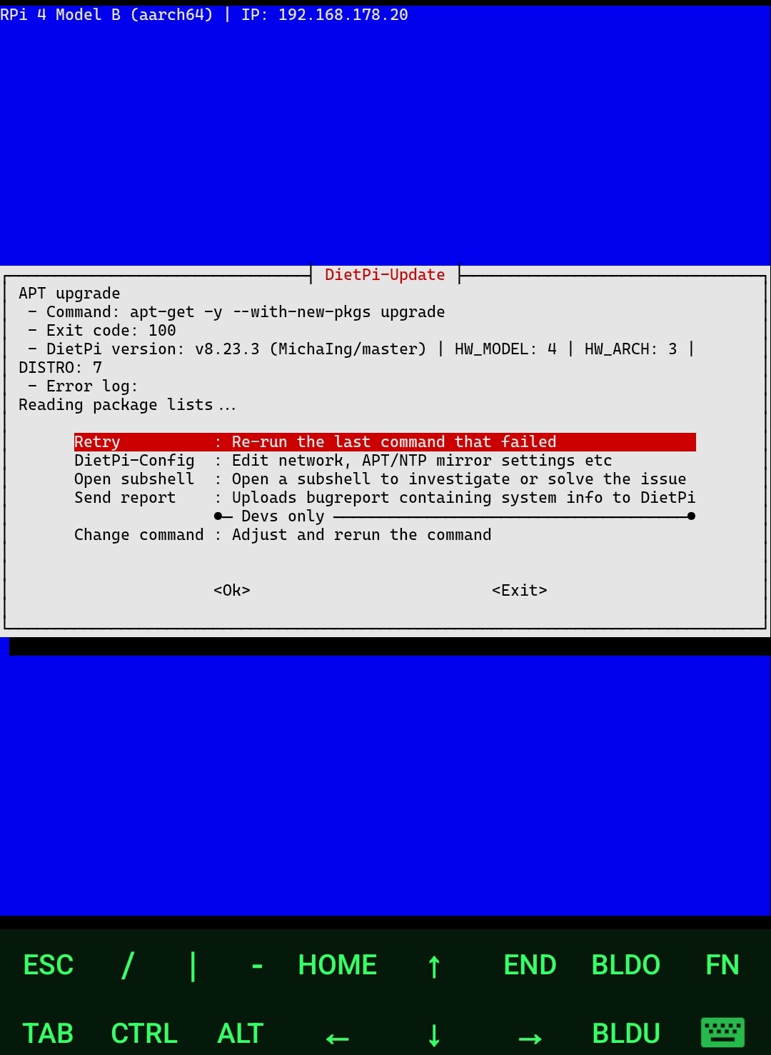

I cannot do the update on my Raspberry Pi 4.
Before the popup with the error message appears, you can briefly read something with rpi-eeprom in the console.
I don’t know much about it, is there a simple copy and paste solution to fix this?

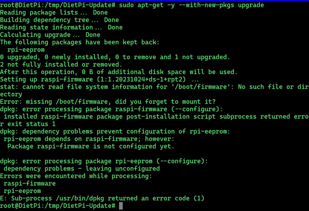

Here comes a message like this:

G_AGP rpi-eeprom raspi-firmware
G_AGUP
G_AGI rpi-eeprom
G_AGP command not found.
Use root user
Great thank you, that was the solution and now the monthly update also worked! :grin::+1:
