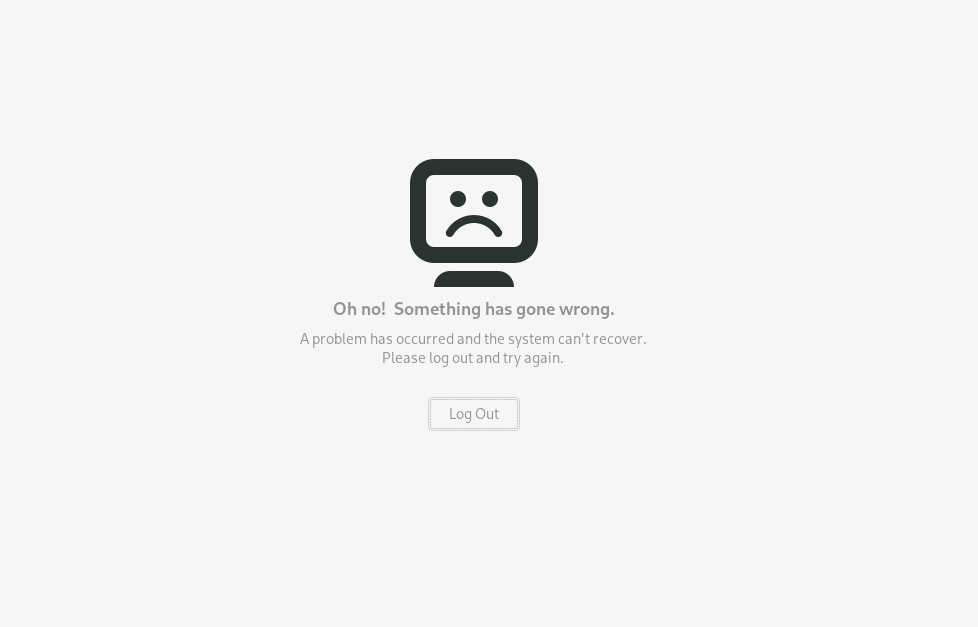

Yeah I bought a Pi 5 which has been running great. I’ve been running into one of the same issues (not the unreachability, but getting this generic error when vnc’ing in which I’m about to do another post on
