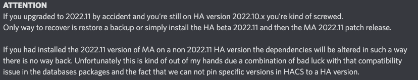

Reason for this is down to what I posted a couple of days ago Homeassistant & Music Assistant and from reading about Music Assistant it seems I did the 2nd part of the paragraph:
So would like to remove HA and start afresh, if possible.
