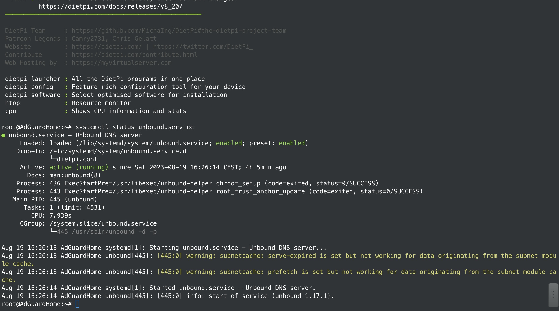

Unbound error prefetch
Hello Community. I have installed Dietpi with Adgauard Home and Unbound and get the following error message ( systemctl status unbound.service ).
What could be the reason please?

This is expexted behavoiur, it’s just a warning which tells you that the option serve-expired is not applied to subnet cache and prefetch by design. This is intended behaviour. (I have same warnings in log)
I was just wondering. I installed Dietpi 8.20 on a Raspberry pi 4 with AdGuard Home and unbound via the software console in one go and this message irritated me after I ran systemctl status unbound.service.

To get rid of these warnings you need to remove these modules from your module config, if you don’t need them.
edit: I had a look into my config file and there are no modules enabled at all :thinking:

So this means this module is precompiled and can not be deactivated easily? Maybe @trendy knows what is going on here?
I made some progress, when you set
serve-expired: no
prefetch: no
the warnings disappear.

I guess these warnings are fine. We explicitly set the values as they are now. Similar is done on PiHole / Unbound guide. At least for prefetch: yes

No error message after > systemctl status unbound.service. Everything is fine. However, a different unbound version is also installed under Bullseye. Maybe it’s the unbound version?
I would not recommend using Bullseye as this is the old Debian version. Way better to use Bookworm. The messages shown by Unbound are no error messages. They are expected due to our configuration.
Yes, these are warnings, not errors and should not have any impact on normal use.
