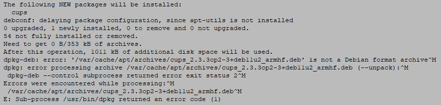

Freshly installed v8.16.2 on an old Rapberry Pi B+.
DietPi dashboard installed first and working.
Then tried to install CUPS using dietpi-software but get these errors… Any suggetsions?
looks like the package that has been download is corrupted. You could try to clean the cache
/boot/dietpi/func/dietpi-set_software apt-cache clean
apt update
Try again to install CUPS now.
Thanks, that seems to have worked!
