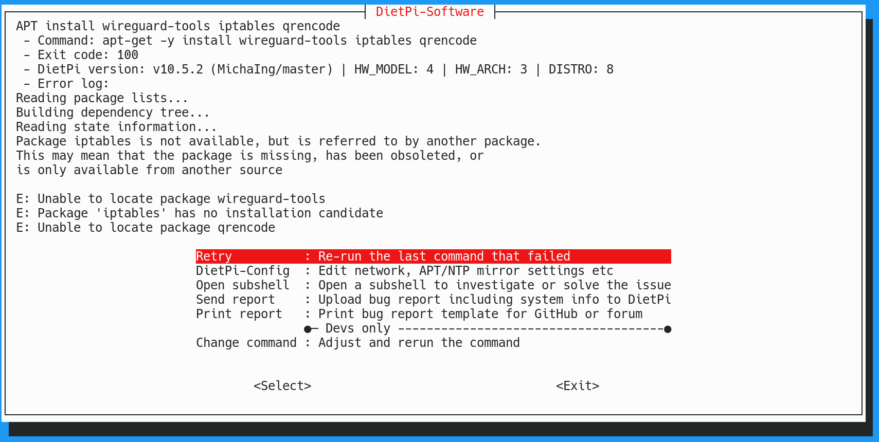

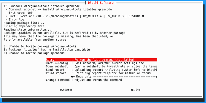

Unable to Install any sofware
G_DIETPI_VERSION_CORE=10
G_DIETPI_VERSION_SUB=5
G_DIETPI_VERSION_RC=2
trixie 0
6.18.34+rpt-rpi-v8 #1 SMP PREEMPT Debian 1:6.18.34-1+rpt1 (2026-06-09) aarch64 GNU/Linux
arm64
Pi 4 Model B (aarch64)
  1. … Either use sudo apt install wireguard
  2. …Use sudo dietpi-sofware
  • the wireguard software should get installed
  • Unable to locate wireguard-tools (diepi software)
  • Unable to locate package wireguard
paste lines of logs or code into such code fences here
can you show following
apt update
