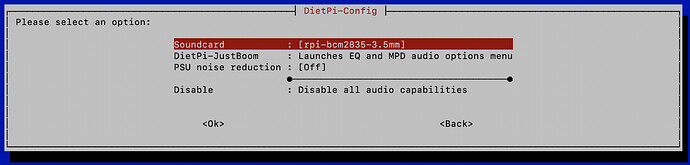

Hello, I have a raspberry pi 4 running the latest version of DietPi (v6.31.2). I have it plugged in to my TV through an HDMI cord, and to my speakers through the 3.5mm jack. I would like to force the audio through 3.5mm so that I am able to use shairport-sync and play audio without having to turn on the TV, but I am unable to do so. I have set the audio to force 3.5mm through the use of dietpi-config > audio options > sound card > rip-bcm2835-3.5mm (also see image below), but no sound comes through until I turn on the TV. Is this an issue with shairport-sync that I need to configure, or something else?
I appreciate any help!
