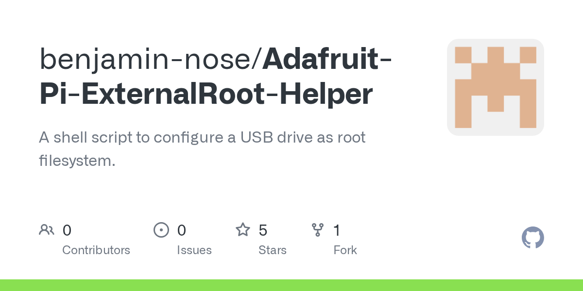

Oh look, somebody forked it and in the issues of the adafruit repo somebody claims it’s working, so you can try that instead
https://github.com/benjamin-nose/Adafruit-Pi-ExternalRoot-Helper

Remove the old folder (the one you cloned from the adafruit repo), then clone from the forked repo, cd into the newly cloned folder and execute the tool
rm -R Adafruit-Pi-ExternalRoot-Helper
git clone https://github.com/benjamin-nose/Adafruit-Pi-ExternalRoot-Helper.git
cd Adafruit-Pi-ExternalRoot-Helper
./adafruit-pi-externalroot-helper
Yeah, I for the longest used the “official” Adafruit one…it was bugged and I could NEVER get ahold of the original creator for a fix…then found the benjamin-nose version and it works on multiple SBC’s and multiple distros (both Orange Pi, Rasberry Pi’s, YouYeeToo X1, straight debian linux, the chinese built distro’s, ubuntu, and dietpi, USB drives, SSD’s, NVME drives) and it just works

OK I see the problem here
export target_partition="${target_drive}1"
It can not handle NVME drives since the partition scheme is different from SATA/USB devices.
On non-NVME you have a device name like /dev/sda and the first partition would be /dev/sda1.
But for NVME the device name is like /dev/nvme0n1 and the first partition is /dev/nvme0n1p1 but the script only appends a 1, which iswrong in your case.
You could just edit that line locally for your script (it’s line 88) and change it to
export target_partition="${target_drive}p1"
so it would work with your NVME drive, but no longer for SATA/USB drives. SOmebody would need to add some logic to detect what type of block device the target drive is.
Here is a one-line-command to change that line for you. When you are in the directory Adafruit-Pi-ExternalRoot-Helper do the following
sed -i 's/${target_drive}1/${target_drive}p1/g' ./adafruit-pi-externalroot-helper
and then run the script again.

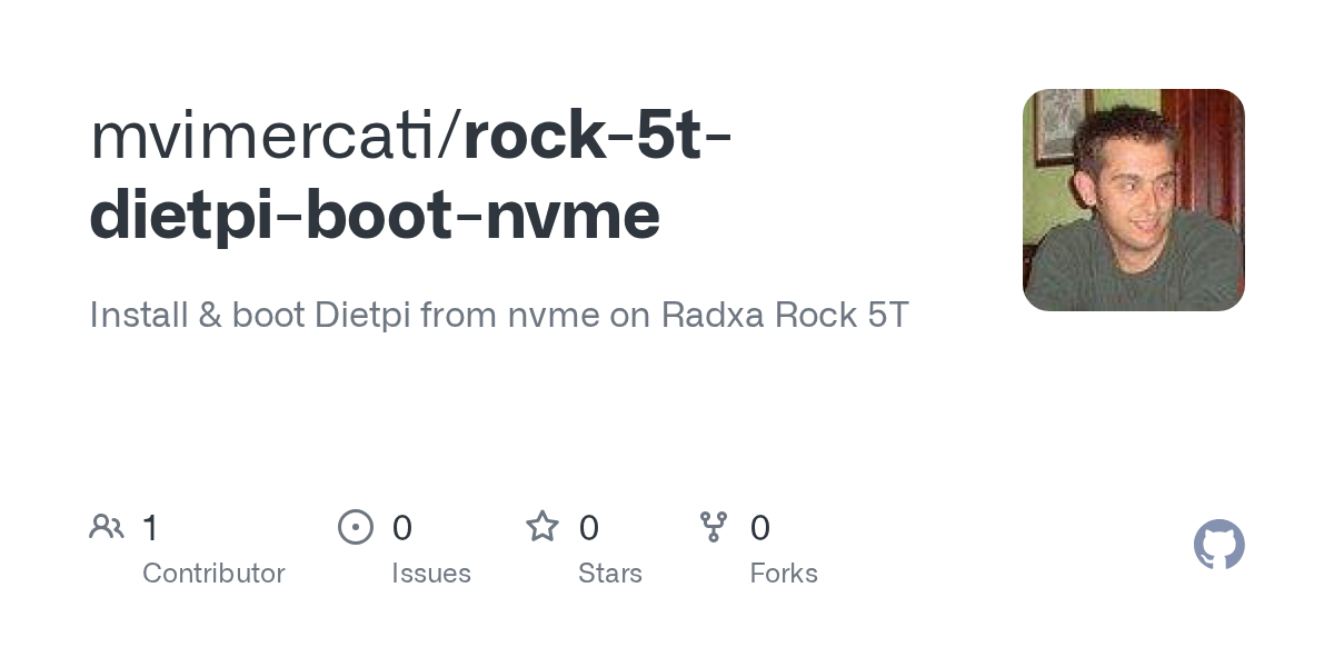

I did a simple guide to install dietpi on Rock 5T, maybe may be usefull for some hints!
Actually flashing the spi with the diet pi u-boot (through the dietpi-config) did not work for me, the board was not booting properly. I discovered looking at debug console on UART interface
