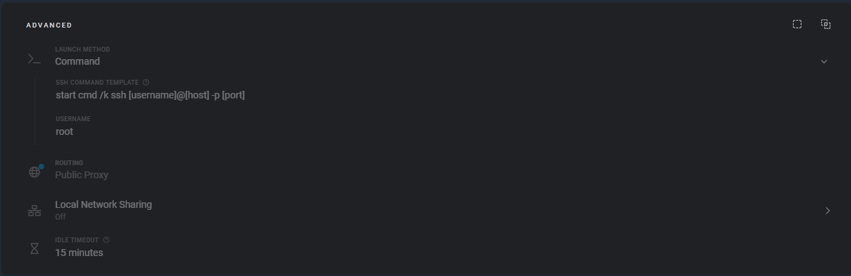

  2. I’ve tried remote.it The device is up but I can’t connect to it. (If I use a ssh connection it is rejected (connection error 1005 -ssh juice- or connection reset -cmd-).
Any help would be appreciated. Thanks in advance.

Any clue why can’t I connect via remote.it?
Thanks
I don’t have experience with remote.it. But you see the server connected on remote.it web site?
Yes, I see the pi connected (online-green) but when I try to SSH the connection is rejected by the RPi.
