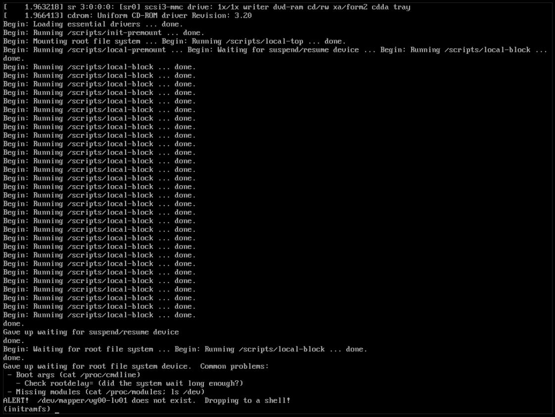

I would like to run DietPi on a VPS Server at IONOS (former 1&1, a Hoster in Germany).
As they offer installing from own images (Supported file types: .vdi, .qcow, .qcow2, .vhd, .vhdx and .vmdk), I first tried installing the pre-built DietPi image for VMware as it is a vmdk-File but it did not work - same error as shown below.
Then I tried converting the ready-to-run image of Debian 10 offered by IONOS themselves to transform this into DietPi with the PREP_SYSTEM_FOR_DIETPI.sh thing (PREP_SYSTEM_FOR_DIETPI.sh | Automate · Issue #1285 · MichaIng/DietPi · GitHub).
The installation itself went through without any errors, but after reboot it is stuck with the same error as when installing the VMDK-File.
Please see the attached screenshot from the virtual KVM-Console.
Has anyone any idea how to solve this?

This is the device mounts on a freshly installed Debian 10 Ionos VPS:
root@localhost:~# df -h
Filesystem             Size  Used Avail Use% Mounted on
udev                   214M     0  214M   0% /dev
tmpfs                   46M  5.2M   41M  12% /run
/dev/mapper/vg00-lv01  7.5G  1.3G  5.9G  18% /
tmpfs                  230M     0  230M   0% /dev/shm
tmpfs                  5.0M     0  5.0M   0% /run/lock
tmpfs                  230M     0  230M   0% /sys/fs/cgroup
/dev/sda1              464M   84M  352M  20% /boot
tmpfs                   46M     0   46M   0% /run/user/0
So it seems that the Script renames the “dev/mapper/vg00-lv01” or changes the mountpoint to /?!
I think this could be solved in the Debian->DietPi Conversion Script somehow?!
Would be really nice if we could get dietpi working on ionos VPS.
Thanks in advance for any help!
