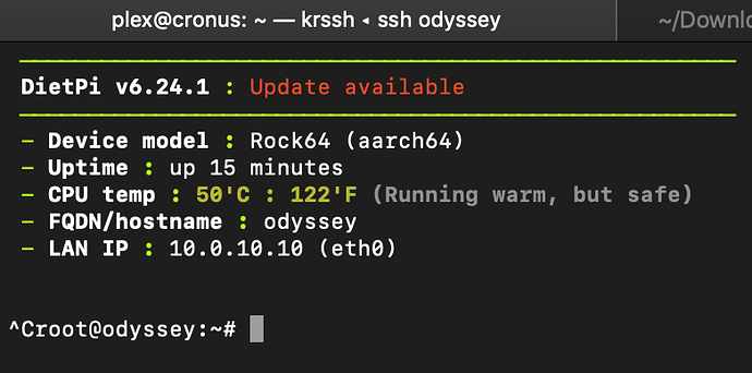

Also I snagged a screenshot of what I mean with the MOD - doesn’t show you much other than where the hangup is - and I’ve not let it sit long enough to see how long it will last, but its definitely more than like 30 seconds that I’ve waited before.
So a bunch of oddities and the date problem leads me to believe there is potentially an on-board problem since it can’t seem to keep time anymore.
