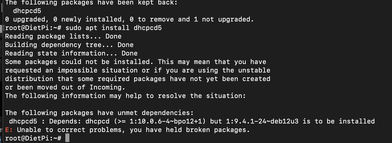

sudo apt-get update && sudo apt-get upgrade && sudo apt-get dist-upgrade
Update software and packages
The following packages have been kept back: dhcpd5
Trying to manually update the dhcpd5 package results in:
The following packages have unmet dependencies:
dhcpd5 : Depends: dhcpcd (>= 1:10.0.6-4~bpo12+1) but 1:9.4.1-24~deb12u3
What should I do? Should I just delete the package dhcpd5?

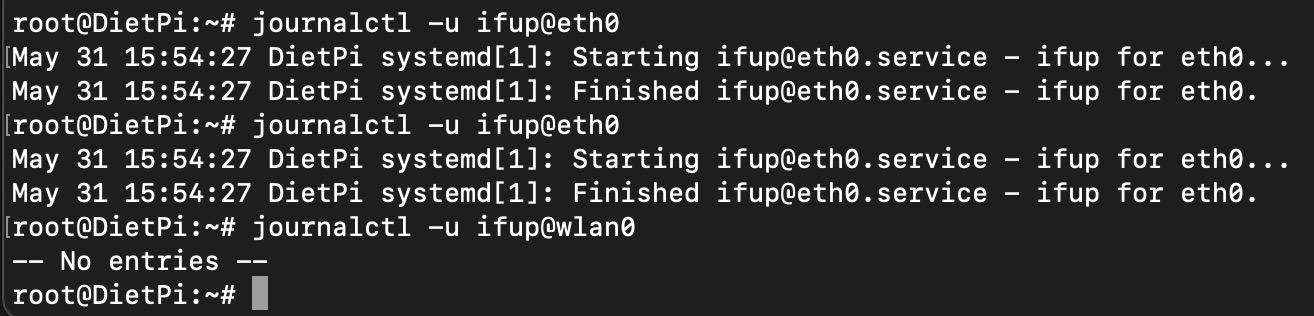

Two things:
  1. Do you actually use dhcpcd as DHCP client? DietPi by default uses isc-dhcp-client/dhclient. Check the network logs: journalctl -u ifup@eth0 or if you use WiFi: journalctl -u ifup@wlan0
  2. You tried to install the dhcpcd5 package from Bookworm “backports”. Was this intentional?
If you did not intentionally install dhcpcd and either no DHCP client is used (static IP), or the ISC one dhclient, purge dhcpcd:
apt autopurge dhcpcd5 dhcpcd
If you intentionally use dhcpcd, first of all purge the transitional dummy package dhcpcd5. The real package is called dhcpcd since Bookworm:
apt-mark manual dhcpcd
If you intentionally tried to install the backports version, do this for the real package now:
apt install -t bookworm-backports dhcpcd
