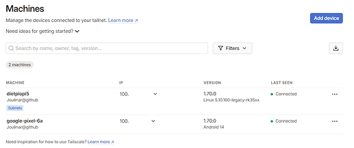

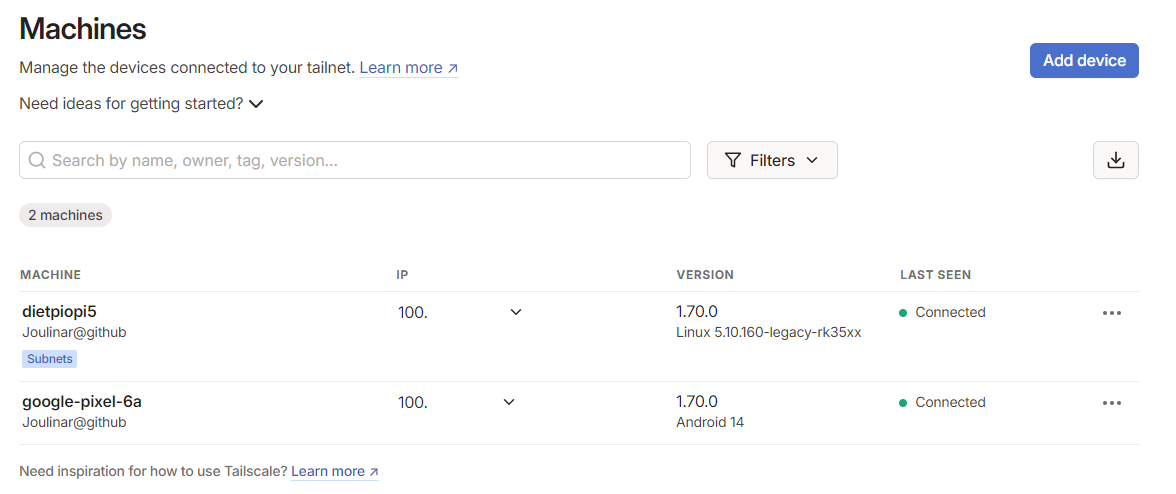

hmm I did a test on a spare OPi5 SBC and it was working ootb. Our install script is already enabling IP forwarding to allow access across network interfaces.
[  OK  ] DietPi-Software | APT install tailscale
[ INFO ] DietPi-Software | Enabling IP forwarding to allow access across network                                                                                                              interfaces
net.ipv4.ip_forward = 1
net.ipv6.conf.default.accept_ra = 2
net.ipv6.conf.all.accept_ra = 2
net.ipv6.conf.default.forwarding = 1
net.ipv6.conf.all.forwarding = 1
 DietPi-Software
 Step: Finalising install
Therefore nothing to do on this side.
The only thing I did was adding my OPi5 to tailscale network
root@DietPiOPi5:~# tailscale up --advertise-routes=192.168.0.0/24
To authenticate, visit:
        https://login.tailscale.com/a/id_xxx
Success.
root@DietPiOPi5:~#
Followed by approving the route on tailscale admin panel

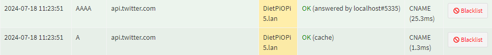

Now I’m able to connect from my mobile phone via SSH to other device on my local network. On a different DietPi system I see SSH login attempt from OPi5 system (192.168.0.22)
Jul 18 11:20:03 DietPiProd dropbear[25505]: [25505] Jul 18 11:20:03 Child connection from 192.168.0.22:56222
Jul 18 11:20:03 DietPiProd dropbear[25505]: [25505] Jul 18 11:20:03 Password auth succeeded for 'root' from 192.168.0.22:56222
Jul 18 11:20:55 DietPiProd dropbear[25505]: [25505] Jul 18 11:20:55 Exit (root) from <192.168.0.22:56222>: Exited normally
As well PiHole is working ootb. Twitter app request from mobile phone are done vie OPi5 now
