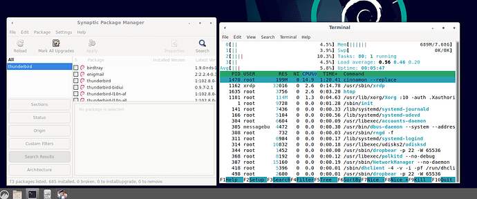

Htop shows cpu utilization of 100% as soon as you try a search and never slows down. After waiting for 3 minutes or so I tried to exit the program but it was ignoring all key/mouse actions. I have duplicated the on 3 different desktops.

Ran synaptic from the menu, but noticed major differences in what htop showed.
Dietpi w/ cinnamon:
htop entries for synaptic looked somewhat like this:
1234 cinnamon-launcher
|_ cinnamon --replace
|_ /bin/sh synaptic-pkexec
|_ pkexec /usr/sbin/synaptic
note: the above entries should indented for each new command, but they seem to show as all starting from space 1. Looked fine when I entered them and are correct in edit mode.

The htop shows an identical setup, only the tree view is enabled on DietPi by default (press F5), which shows parent and child process relations.
