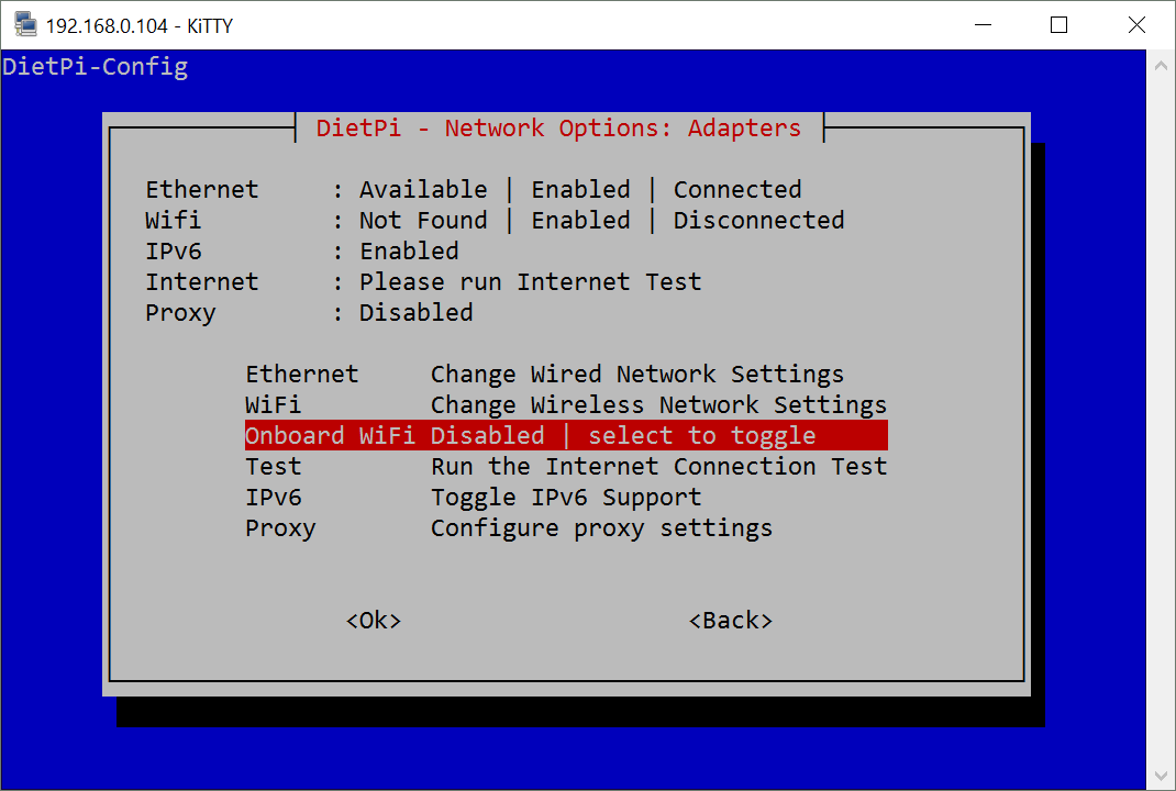

if your device is a RPi3, you can update to DietPi v137 and disable Onboard WiFi from dietpi-config.
https://github.com/Fourdee/DietPi/issues/576#issuecomment-258697142
