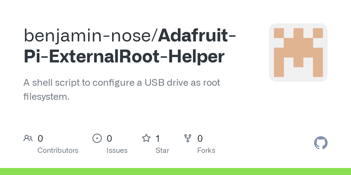

There is a way…but the SD card will hold the /boot partition, then you can midgrate the “root partition” over to any external SSH/HDD using this method
It will rsync everything except the boot drive over to the external USB…then tell the boot script to use the PARTUUID to look for the /root partition on the external USB, the /etc/fstab is also modified to ensure the UUID is correct for the newly mounted and stupidly faster than a SD card
Nice thing is…you can get cheapo 8GB~ SD cards, leave it in, and it will ALWAYS come up…if it doesn’t pop out the SD card, put in a windows machine and scan the fat32 partition for errors. (as long as the root partition isn’t errored out)
Even on slow craptastic USB 2.0 SBC’s like my RPiZero2W an OPiPC an OPiOne, and OPiZero2, it boots from a $4 8GB generic bulk SD card, into a 64GB USB drive externally…and it’s MUCH faster than just a SD card only build. With boot barely every being touched…it rarely if ever has file system issues…and I don’t have to flash an EEPROM on the board and risk having some revision later coming out and crashing my SBC
Biggest thing is BEFORE rebooting after…make sure the /boot/config.txt is correct and the /etc/fstab entries are correct (script should ensure that it’s right…but I borked many a system by having poor scripting [thanks adafruit and {now fixed!!} armbian]
