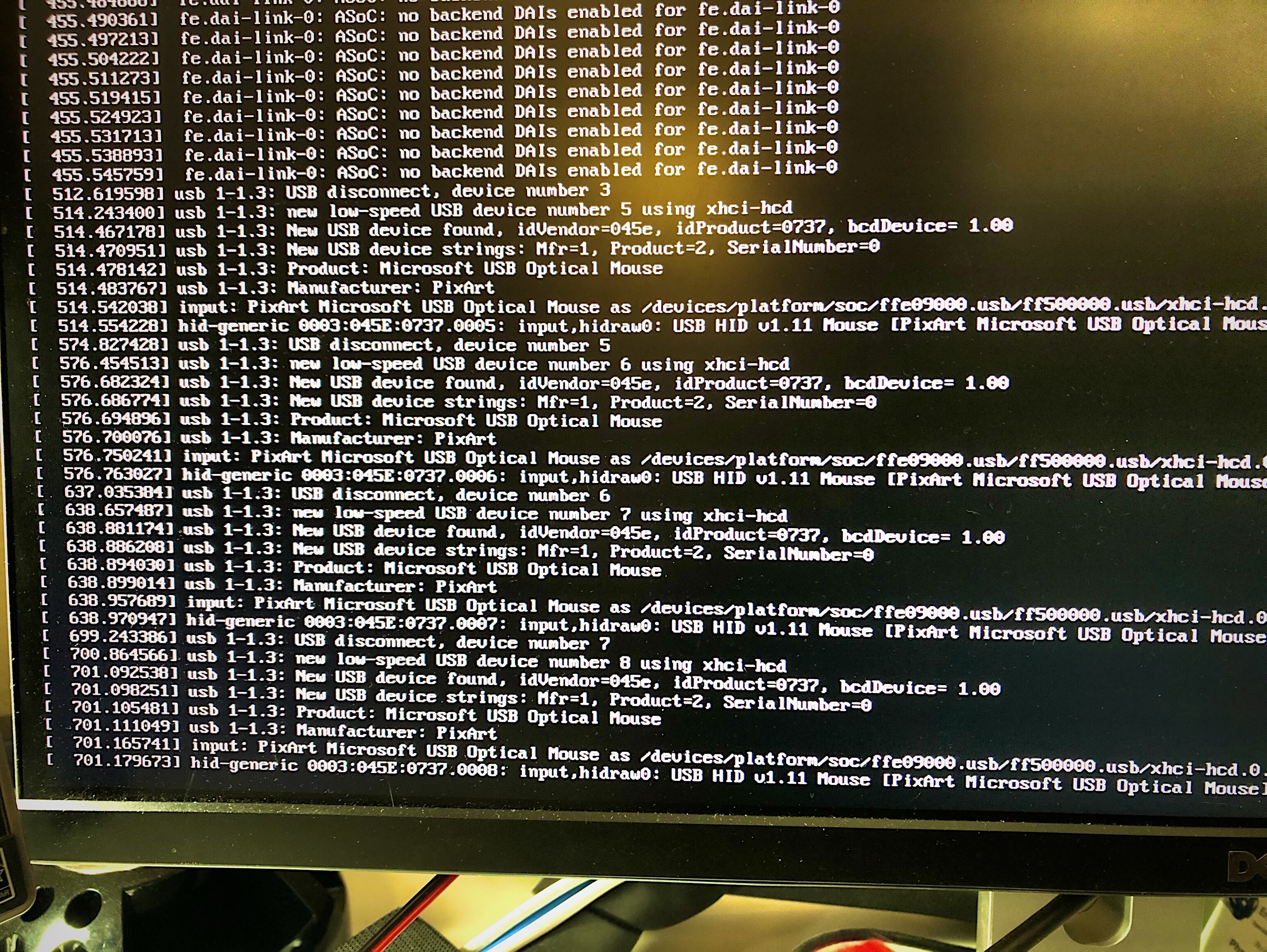

Unfortunately it didn’t work. I tried it twice, once when SSHing into the box, once from a terminal started from within the desktop environment. Downloaded the script, elected to go with the beta version, Bullseye, and keep wifi enabled. Script ran fine for a while, downloaded and installed a stack of stuff. Window manager stopped. Still had the shell. Then it got to a point where it just kept repeating the same info over and over. Shut down and the system wouldn’t boot up again. Tried this twice, from SSH and from local.
See screenshot.

did you used Debian Bullseye before or Debian Buster? Usually there is no difference between Beta or Master as we just released a new version. Looks like a loop of connecting USB devices

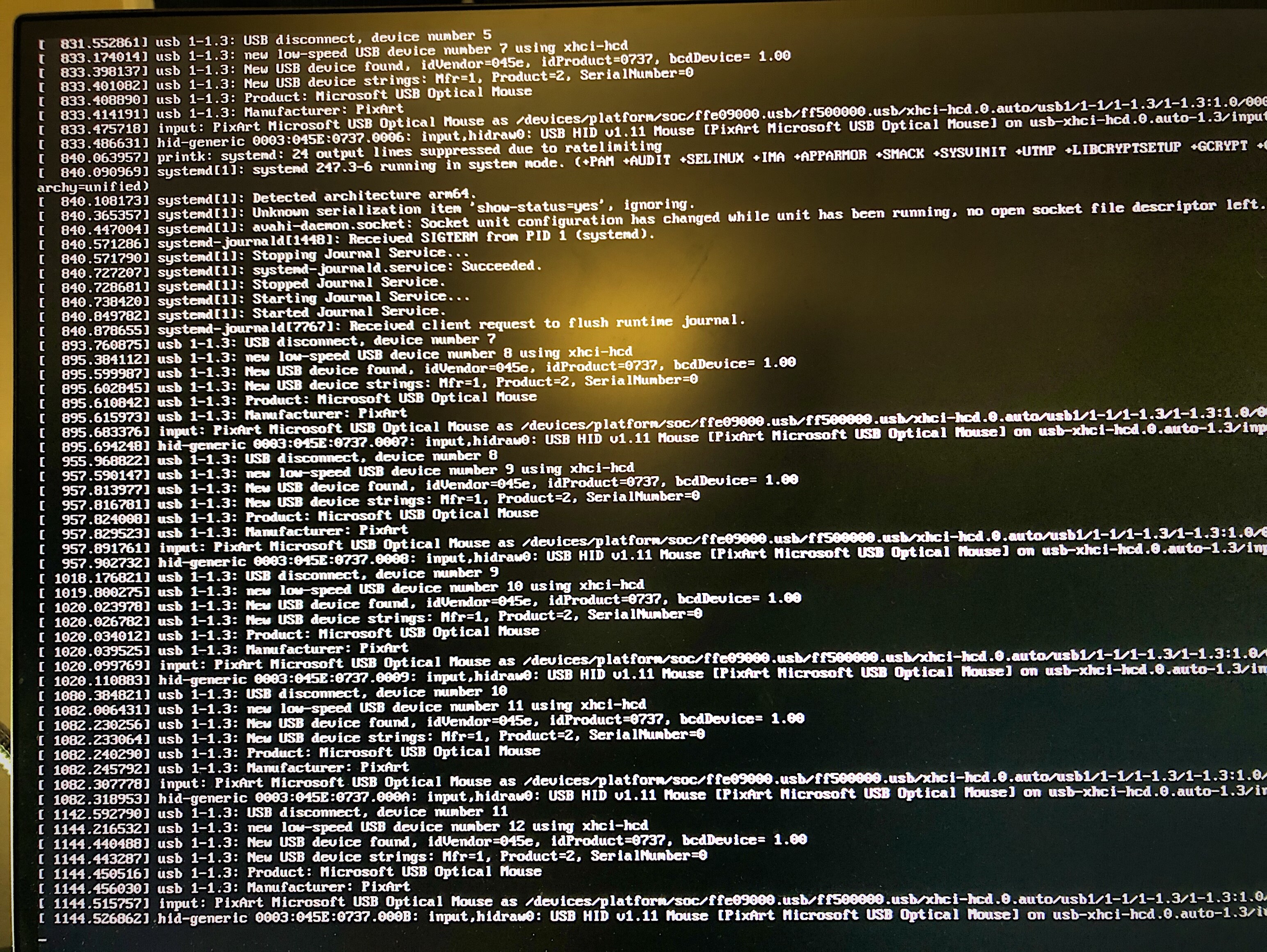

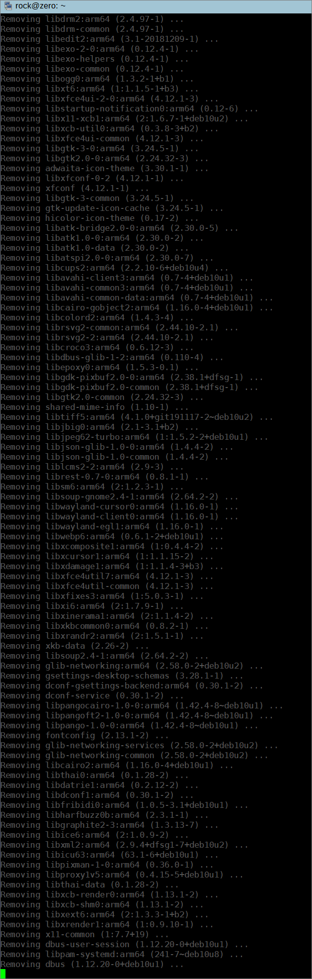

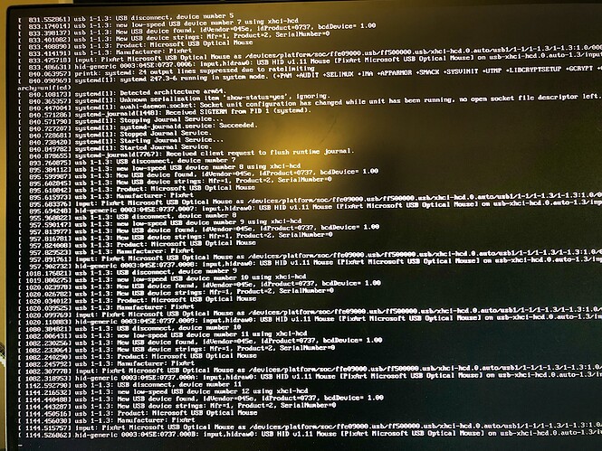

Started from scratch again. Chose all the same options as before when SSH’ing into the box, except selected Buster this time. Again, script seemed to run fine, removed a whole bunch of stuff but the same thing eventually happened. Always seems to die when removing “dbus”. Once again, output on the Zero just shows mouse detected on USB every 60 seconds or something. See screens.

could be our PREP script is purging important stuff needed Radxa Zero device as these things might not be expected. In this case it is not working than.

yes, dbus is something we don’t use/need by default. Is it already freezing while purging the package or just on a reboot?
The script immediately freezes after showing that this package was removed. I waited more than ten minutes. On the actual Zero output window all you can see is that every 60 seconds or so it is polling USB and finds my connected mouse. No other activity and it doesn’t boot up at all if power cycled. It’s in a previously attached screenshot.
