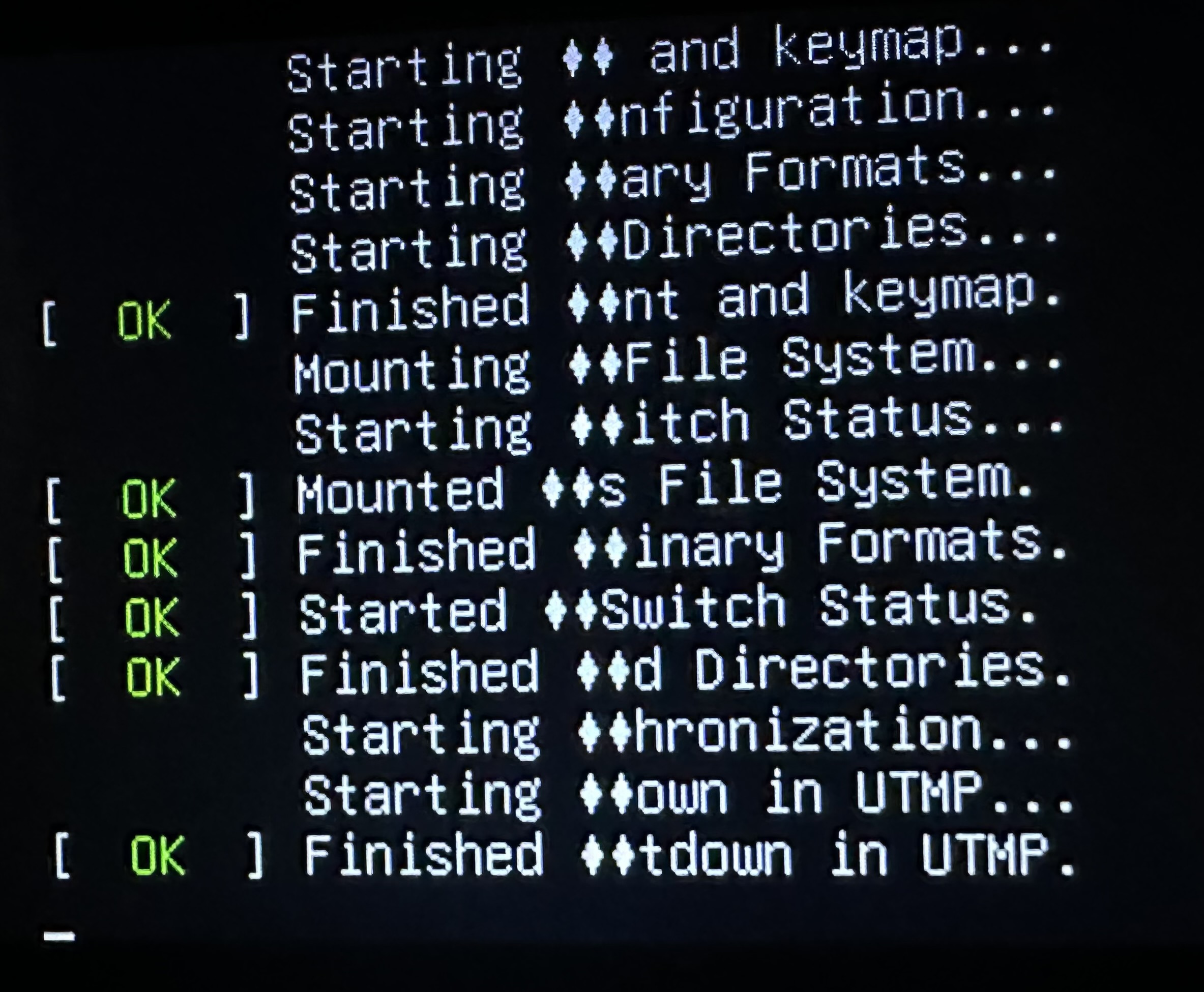

I was using DietPi normally on my RPi 4 with a LCD display and then I ran “reboot” and now it’s stuck on the startup part, all the services are running fine but I can’t enter the TTY.
It’s on a screen with “[ OK ]” and it keeps getting stuck on the “Reached target … Basic System” message. The last thing I ran before rebooting was dietpi-cloudshell. It’s a new clean installation with just pihole, unbound, and pivpn on it. I can access it with SSH perfectly but I want to use my LCD display.
Can you log in via SSH and deactivate the autostart option DietPi-CloudShell. Does the system reboot normally afterwards?
I’ve set the autostart in dietpi-config to “Manual login” and it still does not start up completely after a reboot.
can you login via SSH and export the whole system log using journalctl. The log will be long one, copy it to a text file and attach it to your post. As an alternative, you can use https://pastebin.com/
Aug 02 06:25:58 DietPi systemd[1]: Startup finished in 1.295s (kernel) + 55.642s (userspace) = 56.937s.
Your system takes quite a long time to start up. 1 minute is a really long time. Does the boot process continue after a while?

I’ve disabled Ethernet, and made Wireguard’s port the only open port instead. The system does not continue to start up after a while, i’ve left it over night and it’s still on the same screen and message. I’m not sure why it would take the system a long time to start up, I have minimal packages installed.
can you reboot, wait 5 minutes and share the journalctl again
I ended up just reinstalling DietPi and now it’s working. Thanks for your help.
