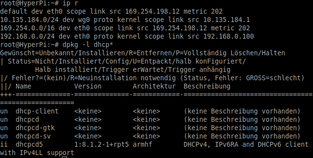

could you share following pls
ip r
dpkg -l dhcp*
VNC-Viewer_dvTVCVZNxq
The issue might be caused by the dhcpcd5 package installed. Any sense for have it installed? Usually it should not be needed as you are having a STATIC IP. If not, I would recommend to purged the package.
WTF!! It works after I uninstalled this package. Is this a bug?
Whats with this 169.254 entry seen in “ip r”. is this normal?
Because this range was always displayed in pings that failed.
Thank you so much!
