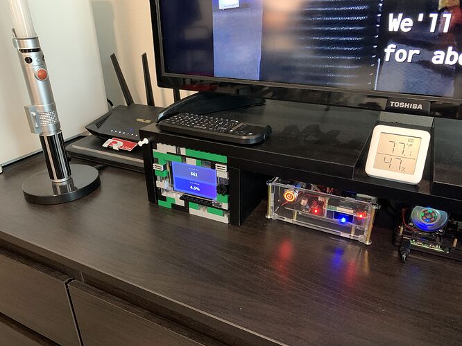

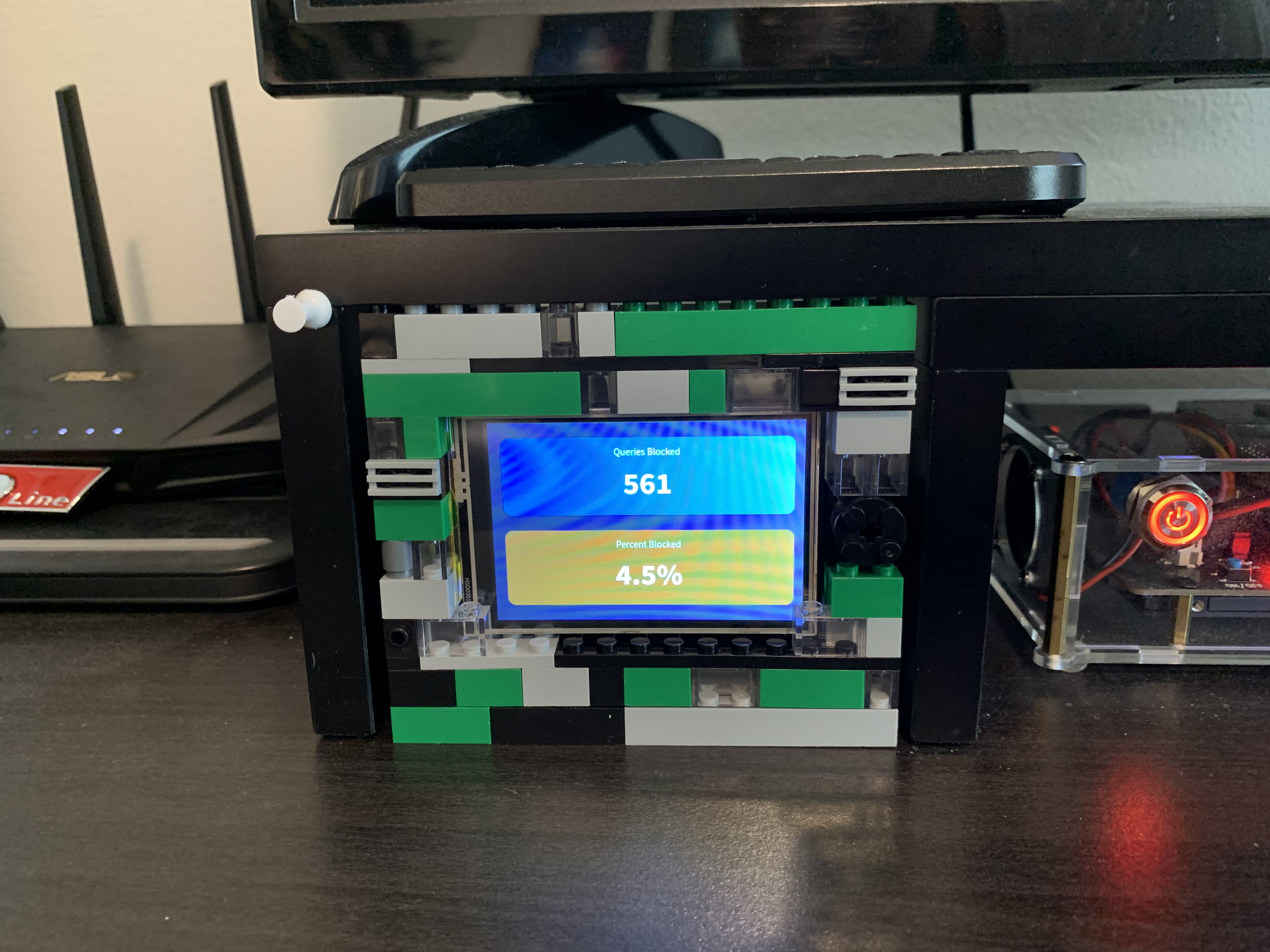

It was refreshing, but after running both PHAD and PADD on the separate Pi Zero (via SSH’ing into the Pi 3B and running either Cloudshell, PADD, or PHAD), I realized that my old (although only 32 years old) eyes were just straining too much so I went back to utilizing DietPi’s Chromium Kiosk with the Pi-Hole Web GUI setup as the default view.
My final configuration works great and is easy to read from most angles. See below for the final outcome of the project - mind you, I am a Trekkie, so I attempted to make it look similar to a Borg Cube (but failed, haha, but it was good enough).
Although, I am struggling to find a solution to having the screen go blank after a certain amount time. I know that these LCD TFT screens aren’t capable of completely shutting off or going into standby mode, but I have seen (many months ago) that it is possible to simply blank the screen - thoughts?

No worries on this any longer. I switched to a 5in LCD (HDMI connected) Screen which allows me to setup screen blanking through /boot/config.txt and it works great. All is well in my kingdom!
