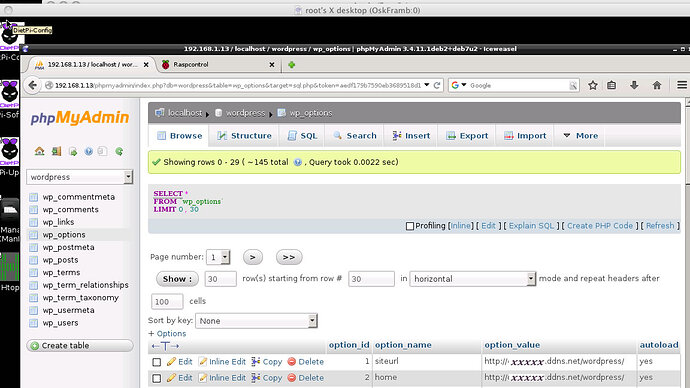

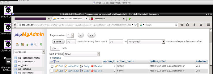

If I set phpmyadmin-database wp-options as local IP it works perfectly locally (image attached) but from the outside it works veeery slow and only plain text.
If I set phpmyadmin-database wp-options as xxx.ddns.net it works perfectly from the outside (image attached) but locally it works veeery slow and only plain text.
