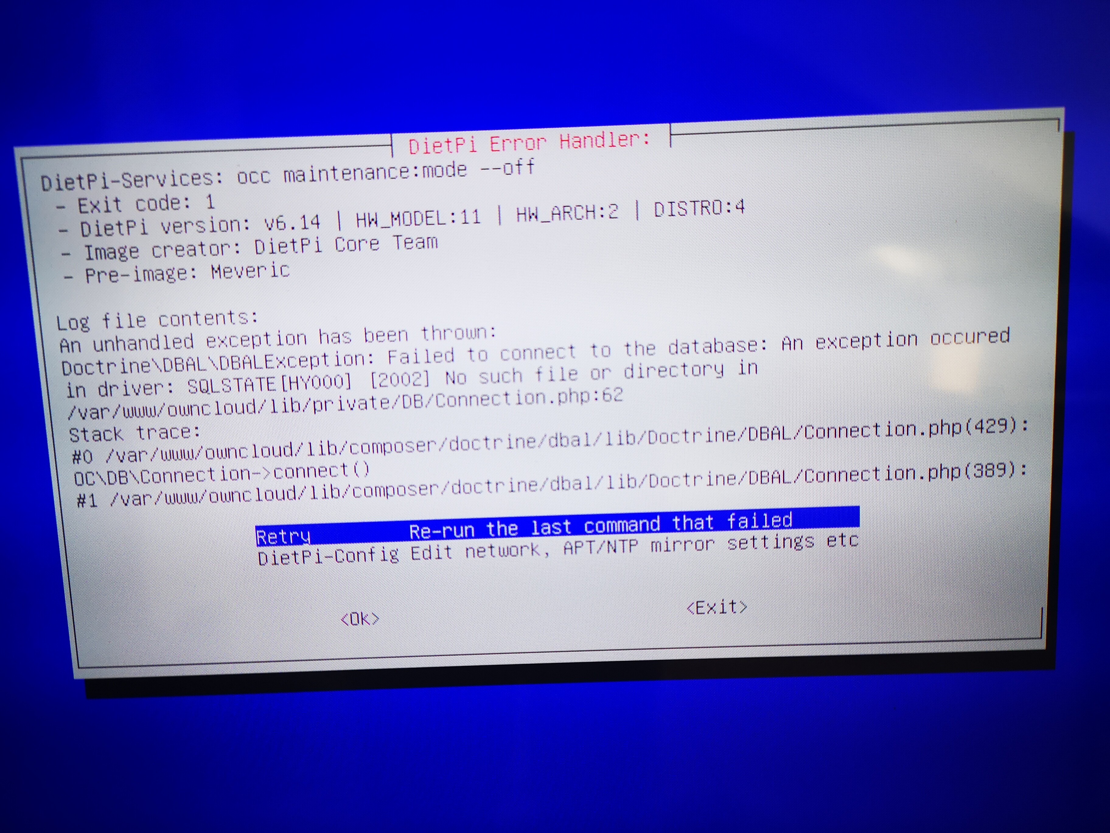

  • Installation got some error messages (see attachments)
  • Executed your Code (see attachments)

Did you need to cancel the install upon the above error message or did a retry work to finish the setup?
If you needed to cancel, please try to skip ownCloud install and do this after first run installs/setup have finished.
I will check this weekend what went wrong with ownCloud, perhaps they changed something with latest release.

On the first run owncloud installed properly (dietpi-software dialog) and after the reboot I exited dietpi-software and installed owncloud via dietpi-software install command (again?). Maybe this caused the error message.

Good that as well ownCloud installed without issue. Just made a quick test here and as well didn’t face an SQLSTATE error.
