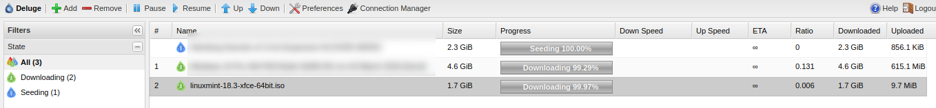

To check that, I put to download the same torrent in the same connection (behind a VPN) on the DietPi with Deluge and in my laptop with KTorrent.
Fresh install Deluge (please note that other 2 torrents NEVER rech the 100%, and one is from official Linux Mint trackers)
My Laptop with Ktorrent
You can see with the has that’s the same torrent. Please look the speed of each… The were added at the same time.

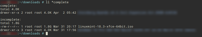

Does you torrent program have write permission for the directories you are downloading (usually incomplete/complete) to?
John
Hi John.
Yes, they have permission. root:root for complete and incomplete.
It’s funny. The test torrent that I add yesterday for post purposes finish (REALLY SLOW) and the others are still unfinished.
I will cry.
Oh my god…
Finally I can figure the problem and you Jonh, gave me a GREAT clue.
The problem was in the owners, not the permissions.
The directories had root:root as owners. I changed to dietpi:dietpi and now the speeds are correct with Deluge.
