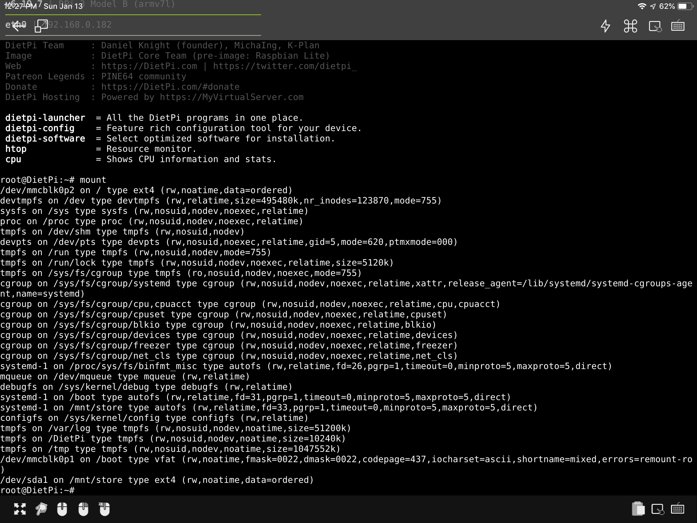

what does mount show
You might need to create a directory on the external mount then point the application to write to that directory
Thanks for your reply. I’ve attached the output from the mount command. I tried creating a downloads folder on store in my dietpi_userdata directory and pointed sab there, but still no love. I can browse store via the sab web interface, so it can at least read from that drive.
