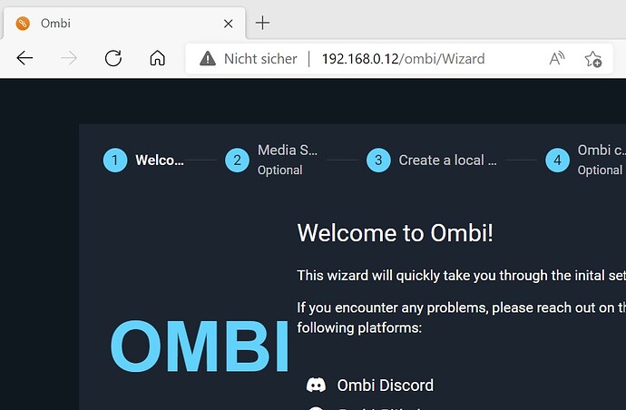

Theoretically you could create 2 files. First one /etc/nginx/sites-dietpi/ombi.conf should contain the location part. 2nd one would be the /etc/nginx/proxy.conf that should contain the respective code block. Reverse Proxying - Ombi Docs
Don’t forget to start Ombi with baseurl specified Startup Parameters - Ombi Docs
At least for me this is working on a very quick test

ok good it is working now :sunglasses:
