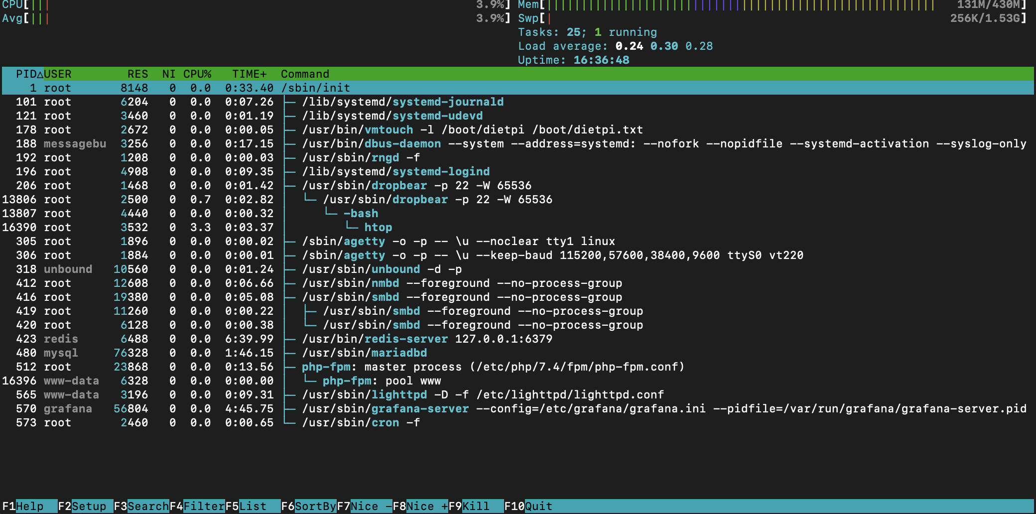

I left the ssh yesterday morning when it was still waiting:
DietPi-Software
 Step: Installing SQLite: Persistent single-file database system
[ INFO ] DietPi-Software | APT install for: sqlite3, please wait...
But yesterday I had to shut down the pi (I moved it elsewhere), and I thought the installation was aborted or at least finished somehow…
Is it bad?
the screenshot shows what I see now.
