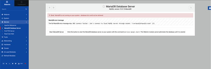

[Solved] Error! MariaDB is not running on your system - database list could not be retrieved
Everything has been working well for several months, and today I go to the server and see that the database is not running, and does not want to start and gives an error… I urgently need to solve this problem so as not to lose the database of my site(
I am attaching screenshots:

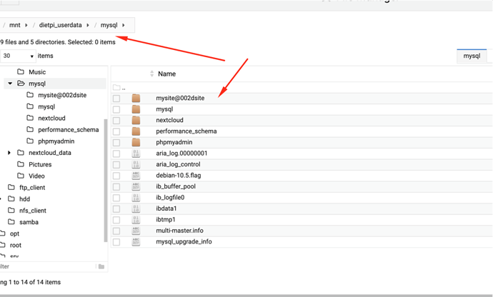

I see that on path /mnt/dietpi_userdata/mysql there are folders with the base, how should I export the dump folder in sql?
I need to export one database, I can see it, but it is in a folder, and I need to somehow convert the dump to sql, since I have already transferred my site to another working server
screenshot db folder

The problem is the files inside your database folder mysite@002dsite. Looks like MariaDB is not able to read these files anymore. Therefore the database server is not starting atm. Moving the files back in place on a new install will most probably result on the same. Therefore you could set force recovery option within MariaDB server configuration file. This should allow to start the database eninge. And maybe you are able to export this specific database later on.
Another option is to copy these specific mysite@002dsite folder away to a save place and try to start MariaDB afterwards. Maybe this will bring back Nextcloud at least.

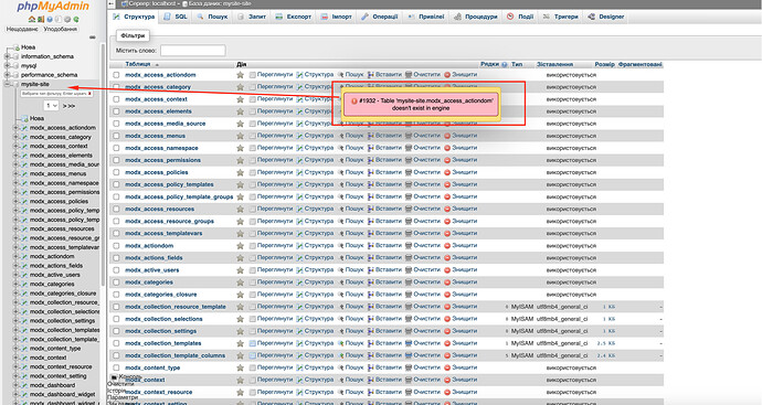

I reinstalled cleanly MariaDB, created a database and a user with the same name and password, then copied the previously saved files to the folder /mnt/dietpi_userdata/mysql/mysite@002dsite/, and I get the following message in webmin((
Is it impossible for me to recover a dump of this database? I know for sure that she is working
