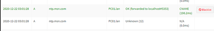

In pi-hole all of my DNS requests have the status “Unknown (12)” now.
Is this the right value? Is with this bundle no more logging in pi-hole possible?

Now I’m investigating the logging, it seems to work as you described, that the first request of a “unknown” host has the status “unknown (12)”, and the next request of the host is “cached”.

Yes, after some investigating:
1.) the first request has status “Unknown (12)”
2.) after that there is a log entry with “OK (forwared to localhost:5353)”.
Thanks!
