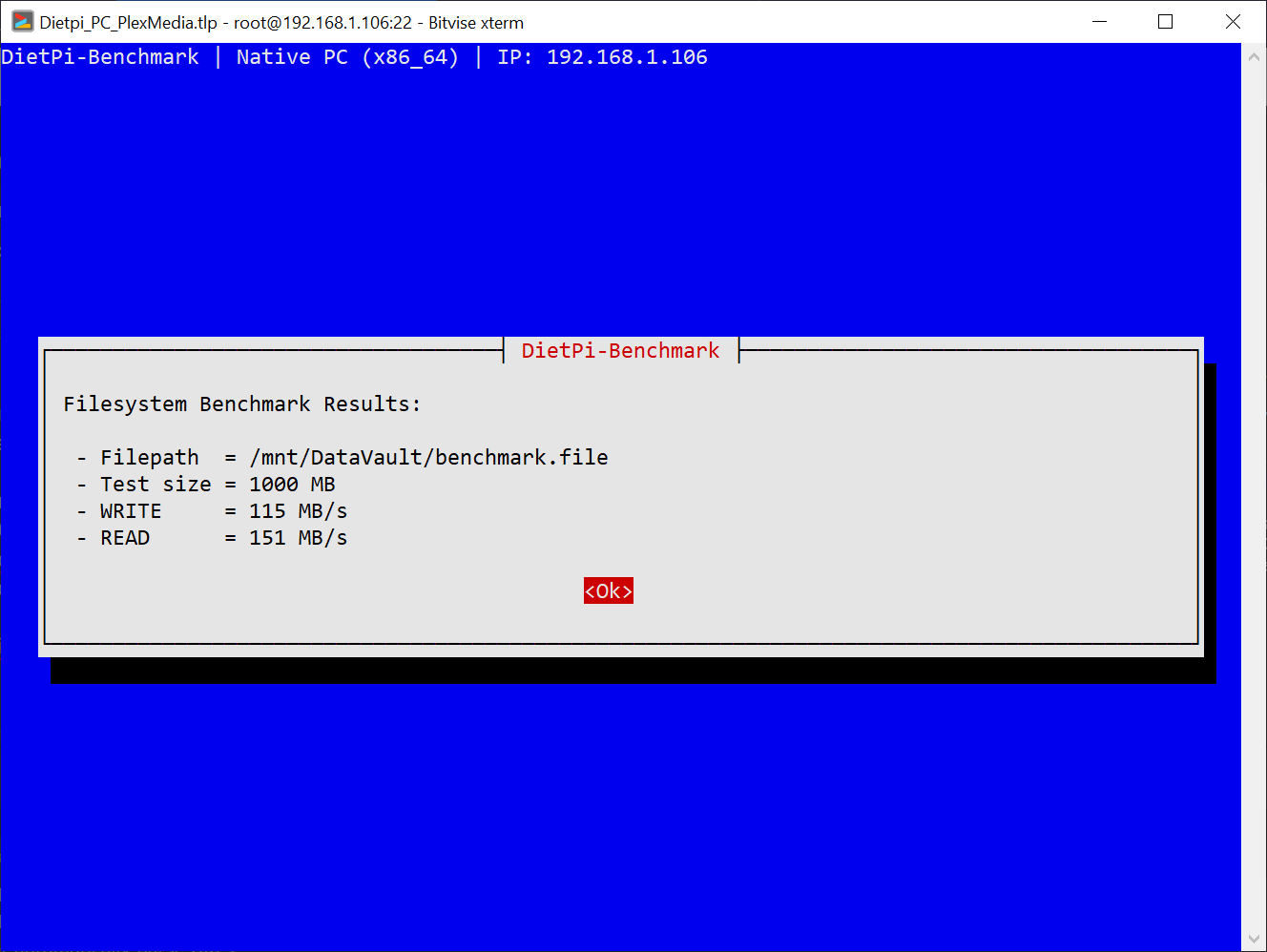

Benchmarked the DietPi drives, both formatted in EXT4
No matter what, sending or receiving from the DietPi PC tops out at 11.7MB/s. I have over 4TB of data I need to get host on this DietPi PC. It would take 48hrs+ to get it all transferred. Way too slow. What am I doing wrong?
Note: The DietPi HDD’s were tested on the Win10 machine before the build so I could verify the speed for transfer. The results were well over 97MB/s on both. However I didn’t take screenshots as I was not expecting to have a transfer issue.
