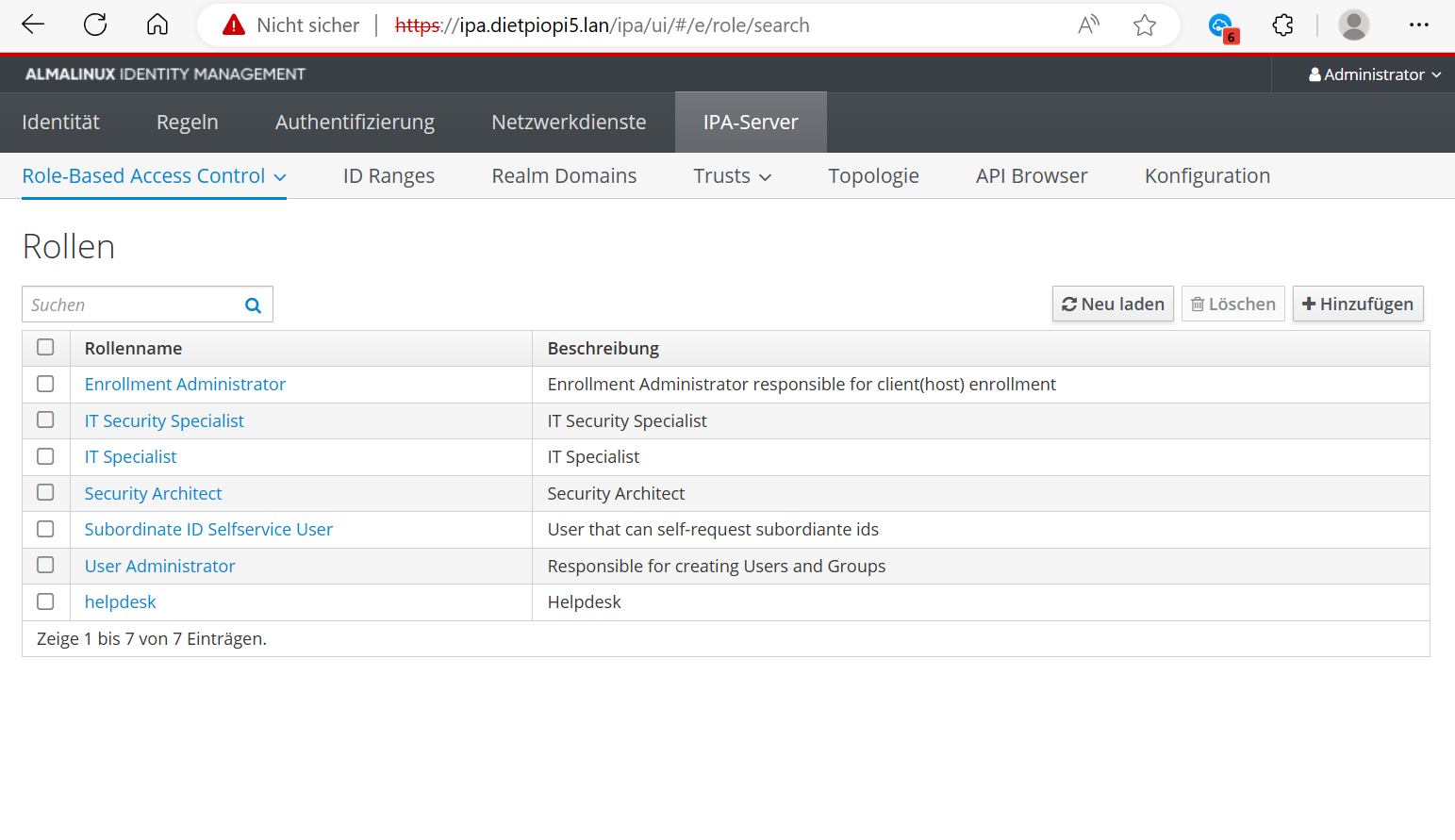

Last time when it asked me for corfirmation to proceed, I blindly hit enter where the default is a “no”. So the installation exited. (Installing is going on right now on rockpi4c with ubuntu 20.04.6)
Thanks @Joulinar . I was able to build using both the Dockerfiles (almalinux9 , rockylinux9) and run them successfully. I will try to run on dietpi + rockpi-s and share my findings
