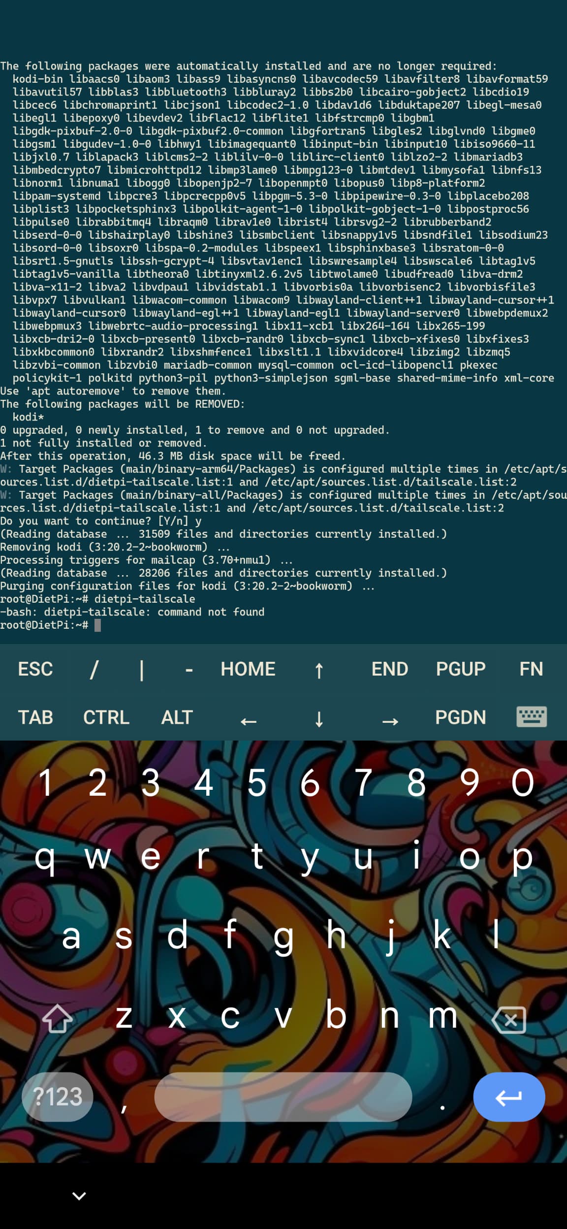

One more request from my side. Pls try to avoid screen prints. The one you shared is soooo small and honestly, I have no idea what you trying to say with it. If possible, connect via SSH and copy all relevant information from SSH terminal directly. This is way better readable.
Why are you doing apt purge
on a clean installation??? If this was a fresh install/image, nothing should be left behind.
As far as I can see, you tried a command dietpi-tailscale
. Such a command never exists. What do you get this? You need to install Tailscale from our software catalogue. But actually there is an issue with the official Tailscale apt package and you would need to install iptables in addition. DietPi-Software | Tailscale: Startup fails because of missing iptables · Issue #6649 · MichaIng/DietPi · GitHub
